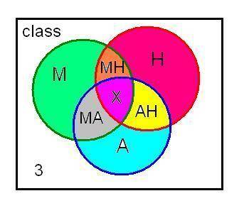

I know, that probably this will sound to be a dumb question but I can't find the solution to it. So if anyone could help please ?
In a class of 40 pupils,
18 take Mathematics
19 take History
16 take Art
6 take both Mathematics and History
5 take both History and Art
7 take Maths and Art
and 3 take any of the 3 subjects
(a) Draw a venn diagram to show the given information
(b) Use the diagram to find the number of pupils who take all the 3 subjects
The part " 3 take any of the 3 subjects " confuses me.
Edit : If possible post the link to the image of the Venn Diagram with the works.
I tried doing it by drawing a Venn diagram with 3 sets intersecting each other. I placed X where all the 3 sets intersect. And then I came to a point where I was stuck at -2X+35=40.
How can the answer be negative ? So that's where I am.

I think that was meant "3 do not take any of the 3 subject".
Show your Venn Diagram. ehild

The question can be wrong. Or you copied it wrong. Ask your teacher, what the sentence "3 take any of the 3 subjects" mean.
In problems like that, there must be a sentence indicating the number of those who do not belong to any of the sets. It can be that everybody takes at least one of those 3 objects, or there are 3 people who do not take any of them. Try to solve both cases.
If you add all people who study either Maths or History or Arts, you count those twice who study two objects and those who study all tree ones, you count tree times.
Find how many people belongs to each coloured fields and write in.
x students study all three objects. 6 people study both Maths and History, but the number 6 includes those who study all tree, so 6-x study only Maths and History. Find how many study History and Arts but no Maths, and how many study Arts and Maths, but no History.
Then find the number of people who study only one object: Maths or Arts or History, exclusively. If you add the numbers belonging to each different field and add those who do not take any object you get the number of the student in the class.
