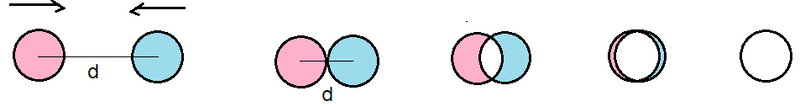

From the OP:
Consider two balls of equal radii and masses but opposite charges, distributed uniformly over their volumes.
Far away from each other, the potential energy of the system of the two balls is -kQ2/d. When they just touch each other, d=2R. Assume a Gaussian surface that encloses the two balls. Keep this surface. When interpenetrating, the -ve and +ve charges neutralize each other in the common volume . What happens with the electric field around the spheres? What is the net charge and the electric field when the centres coincide? What is the electric field on the Gaussian surface? What is the electric energy then?

One sphere has some potential energy in the field of the other one, but the two spheres make a system, and the whole system has some potential energy according to their interaction. When far away, there is the Coulomb force -kQ2/r2 between the spheres and the potential energy at distance d is the negative integral of this force from infinity to d.

Sir, I couldn't understand how the Gaussian surface looks. Is it along the periphery of the 2 balls when they just touch each other?
ehild said:
From When interpenetrating, the -ve and +ve charges neutralize each other in the common volume . What happens with the electric field around the spheres?
Sir, I don't know the answer to this. I know that the flux remains constant, but I'm not sure about the electric field. I don't think that it should remain constant over the Gaussian Surface (assuming the surface is along the periphery of the 2 balls when they are just touching each other).

Sir, from my understanding, the net charge becomes 0. Thus, the net electric field over the surface would also be 0. Accordingly, (I'm not sure about this) the electric potential energy should be 0. Am I correct, Sir?
The net flux along a closed surface that embeds booth spheres would be zero. if you choose a surface which includes only one of the spheres, the flux will decreses as the spheres interpenetrate and some of the charges neutralize.

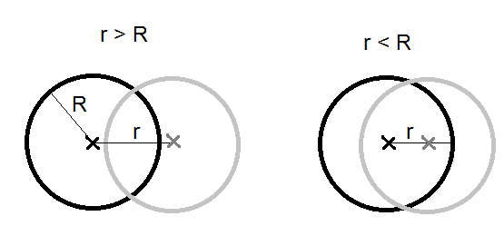

This is rather a difficult problem and I do not know the solution. You can not simply apply that the kinetic energy + electric potential energy is constant, as the charge changes. You can see from the picture in Post #24 that there is attracting force between the spheres till the centres are apart. When they coincide the electric force between the centres becomes zero. The acceleration of the centres becomes zero, and the speed is maximum then.
Maximum acceleration means maximum force. The question is, how the force changes as the centres approach, and at what distance it is maximum.
It would be very difficult to calculate the force from the charge distribution shown in figure in Post #24. Try to apply the method, based that the electric field at distance r < R from the centre is proportional with the charge embedded in a sphere of radius r. How does the electric field change with separation with this approach?
