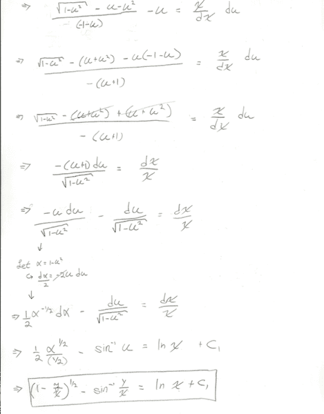

I thought I was about to go nutty :redface::biggrin: Ok. Taking into account the sign error AND the fact that I "double divided" the last term in (6) by x^2, the newly corrected line (6) should be:
[tex] \sqrt{1 - u^2} - u - u^2 = -(1 + u)(u + x\frac{du}{\,dx})\qquad(6**)[/tex]
which is separable. I did not have the sign error on paper, and it was not what caused the eqaution to be inseparable, it was crappy algebra skills.

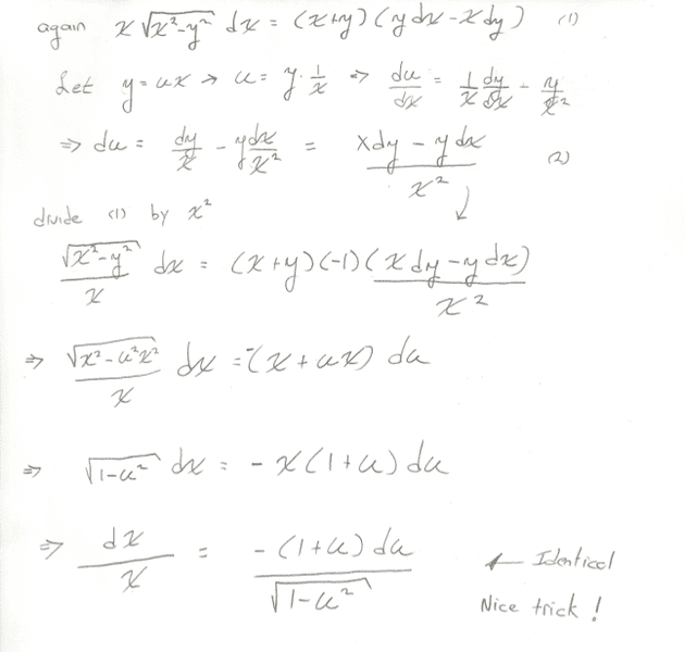

Thanks for your patience tiny-tim! :smile: I'll post back with the full solution soon and then I want to try it your crazy d(y/x/) way. I think I now see where you were going with that. Had I divided by x^2 right off the bat, I would have had exactly the expression for du, assuming that I was using y = ux --> u = y/x. However, having never seen that 'trick' before, I never would have thought of it on my own. I definitely am going to try it since it seems like it could be a lifesaver on a test (but only if you know that it's there).
That trick is so good!
You've still made things a bit complicated:
[tex] x\sqrt{x^2 - y^2}\,dx = (x+y)(y\,dx - x\,dy)\qquad(1)[/tex]
is just
[tex] x^2\sqrt{1 - u^2}\,dx = x (1+u) du[/tex]
or
[tex]x\, dx = \sqrt{ \frac{1+u}{1-u} } du.[/tex]
Hmmm... I don't know. I got the same answer twice with different approaches and it doen't look like that fzero. Either way, I'll take it! :smile:
Hi Saladsamurai! :wink:
Your dx/x solution looks correct to me
(and you've corrected the mistake in sign I made in my post #4) :smile:
