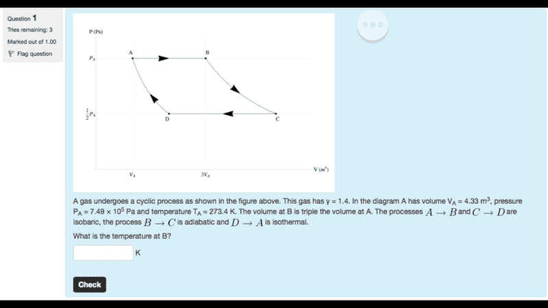

A gas undergoes a cyclic process as shown in the figure above. The gas has gamma = 1.4. In the diagram A has volume V_A = 4.33 m^3, pressure P_A

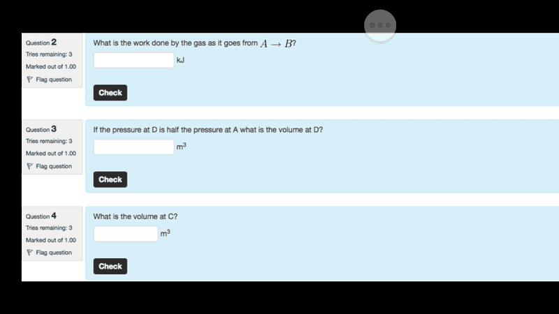

Your answers for Q 1,2 and 3 look correct. Have you attempted Q4?
Hint:
If I remember correctly for an adiabatic process..
P1V1γ = P2V2γ
If I've got that wrong perhaps someone can correct me.
