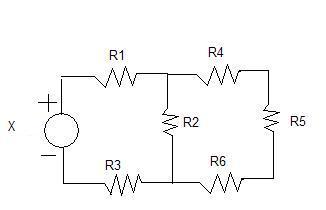

Write six equations using the unknown currents I1, I2, etc.
Circuit included as attachment.
Ohm's law
So I1, and I3 are fairly straightforward.
[tex]I_{1}=\frac{X}{R_{1}}[/tex]
and
[tex]I_{3}=\frac{X}{R_{3}}[/tex]
Now I get confused. Because the voltage divides, I am unsure of how to attain the equations for the remaining currents without using the mesh current method.
Thank you for the help.
Edit, and now I realize that I3 is not X/R3, but rather I3=I1, but my confusion still stands about the best way to retrieve 6 equations.
Perhaps they want you to use Kirchoff's laws, as suggested by the problem title?
Hint: Kirchoff's laws involve the various loops and nodes within the circuit.
