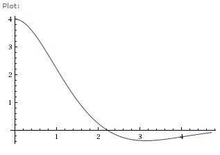

Here is a plot of the displacement function:
  • Plot of a decaying oscillating curve against t, starting at 4 on the vertical axis at t=0, falling through zero near t=2.2, reaching a shallow minimum below zero near t=3, then rising back toward zero.
