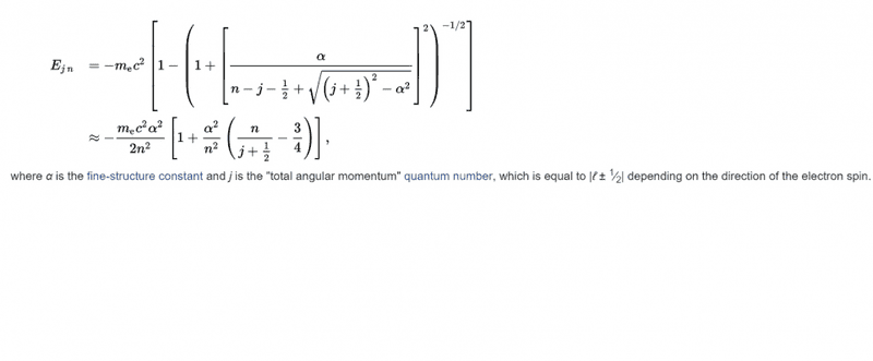

gleem said:
@Isaac0427
Sorry about the little disagreement about the quantum numbers. We seem to a different view of what is important to say to you given that you may be new to this subject and may not as yet developed the tools to work through the problem. The quantum numbers n,l,m come out naturally in the solution of the Schrödinger eq. what l and m mean at this point is not appreciated by the novice. The energy of the shells (orbit is a misleading term) is determined only by one of the quantum number, n with l and m just numbers associated with n.and n being the specification of the shells outward from the nucleus. The quantum numbers l and m have no influence on the energy of the electron. We should not at this time quibble about the significance of l or m.. As it turns out l is related to the angular momentum of the electron and m are related to the values of the projection that l can take along a preferred axis once it is establish as for example the direction of an applied magnetic field to the hydrogen atom.
I would recommend that you get a pre quantum mechanics modern physics book to get an historical overview of experimets and theoretical attempt to deal with quantum phenomena and atomic models. This will give you a background and help you navigate the quantum mechanical approach to the solution of pre quantum mechanics issues.
from wiki
https://en.wikipedia.org/wiki/Hydrogen_atom
http://blob:https://www.physicsforums.com/fc709ddf-c6b7-452b-9d31-d36725f5bedb
