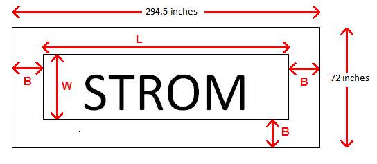

A new rectangle with the word “STROM” is to be constructed inside the mat of an outside rectangle. The width of the mat surrounding the rectangular “STROM” logo will be the same. The area of the boundary around the word “STROM” will be the same as the logo itself. Determine the uniform width of the boundary.
i made a picture of it including the measurements from the sheet:
http://img188.imageshack.us/img188/4315/strompic.jpg
294.5 inches x 72 inches = 21204 inches
i really don't know what to do, please show me step-by-step directions on how to solve this so I can understand and learn from it. Thanks!:)

One approach I use with this sort of problem is to give variables, for everything, and then write down as many equations as I can.
For example. You have used L and W for the length and width of the logo. Now also use B for the width of the boundary.
Can you write expression using L, W and B for the length and width of the whole mat?
Length: 294.5 = ?[L,W,B]
Width: 72 = ?[L,W,B]
I'm also a big fan of drawing pictures. You can label your diagram with L, W and B, to show what lengths and widths they refer to in the problem.

Here's the diagram I suggested for you, labeled with L, W and B.
Can you give n expression in terms of the variables for the total length?
294.5 = ?

That's using a new variable for the total length, and you know its value. I often use variables for known values also.
But what I am asking now is for a new expression, which captures something you know about the problem. Specifically, the total length "n" can be given in terms of your other variables L, W and B in the diagram.
n = ?
Replace the ? with an expression involving the other variables.
is it...
294.5 = l + 2b
72 = w + 2b
brittney1993 said:
is it...
294.5 = l + 2b
72 = w + 2b
That's right!
You now have given three equations, with three unknowns. The other one is the equation you gave back in [post=2220405]msg #11[/post].
You want to find "b". You can re-arrange the two equations here into the form
L = ?
W = ?
where ? are expressions using "b". You use these expressions for L and W in your earlier equation in [post=2220405]msg #11[/post], you will have one equation, with one variable, and you have to solve that for the answer.
