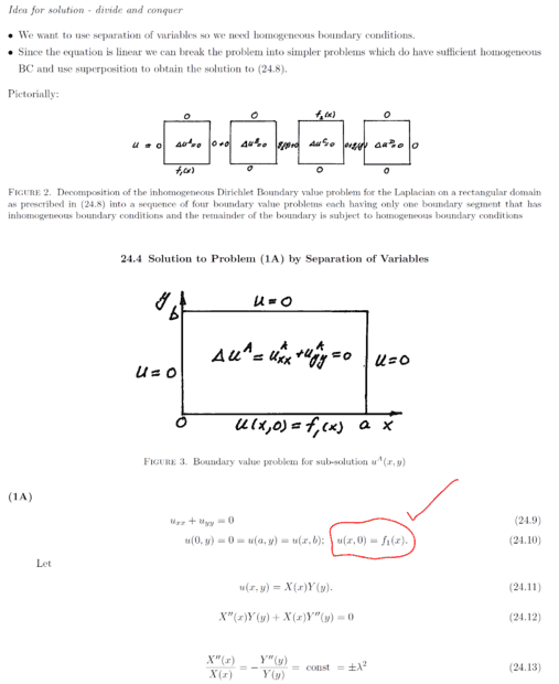

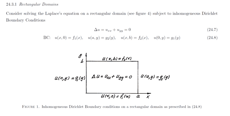

I am looking at Laplace equation. The beginning steps are pretty clear...kindly see attached... I need some insight on the given boundary conditions
Rectangular domain with corners at the origin and (a, b), boundary labelled u(x,0)=f1(x) at the bottom, u(x,b)=f2(x) at the top, u(0,y)=g1(y) on the left and u(a,y)=g2(y) on the right, interior marked Δu = uxx + uyy = 0.
We have inhomogenous dirichlet boundary conditions (well understood)....the laplace equation is a steady state equation and we can clearly see that in 2D..it will be defined by 4 boundary conditions and NO initial condition...having said that; kindly have a look at the continuation below...

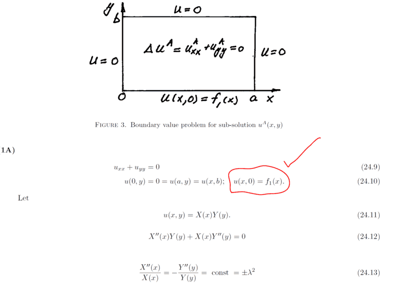

Handwritten sketch of a rectangle from (0,0) to (a,b) with the Laplace equation Δu^A = u_xx + u_yy = 0 inside, u = 0 on the left, top and right sides, and u(x,0) = f_1(x) on the bottom side.
I can follow the steps; In the attempt to solve; they made ##3## boundary conditions homogenous thereby leaving one inhomogenous boundary condition to work with to realize steps to solution...
Now my question is; Why the choice of ##f_1(x)## ? or it does not matter...could we as well have worked with ##u(0,y)=g_1(y)## and made the other ##3## conditions homogenous? The other steps are not difficult to follow....am on that now cheers!

chwala said:
TL;DR Summary: I am looking at Laplace equation. The beginning steps are pretty clear...kindly see attached... I need some insight on the given boundary conditions
Now my question is; Why the choice of f1(x) ?
The example simply chooses one of the edges to be a nonzero function. The choice is arbitrary and could be any edge (although a particular choice may make the notation simpler)
Ok I will explore this...looks like if we were to use ##g_1(y)## then I guess that we shall be dealing with solutions (both general and particular) in terms of ##y##...
Hmmmmm...getting to understand this isn't a walk in the park...spent a whole 25 minutes trying to go through the problem...Will post my area of doubts/clarity later...
The problem is linear; you can decompose it as the sun of four problems, each of which is homogenous on three sides and inhomogenous on the fourth.

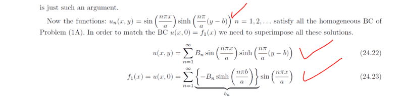

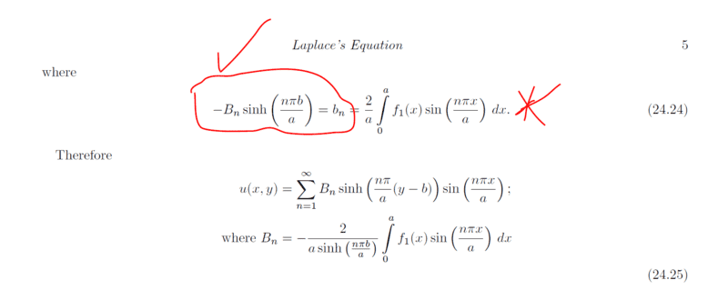

I am conversant now with solving this problem at ease; just need some clarification on the highlighted part;
Printed lecture notes with two equations, (24.22) u(x,y) as an infinite sum of B_n sin(nπx/a) sinh(nπ(y-b)/a), and (24.23) f1(x) = u(x,0) as an infinite sum of {-B_n sinh(nπb/a)} sin(nπx/a), with the bracketed term labelled b_n and red check marks.
Printed page from Laplace's Equation notes showing equation 24.24, -B_n sinh(nπb/a) = b_n = (2/a) integral from 0 to a of f1(x) sin(nπx/a) dx, with a red hand-drawn circle and arrow, then equation 24.25 for u(x,y) and B_n.
on the integral part... looks like something to do with Fourier?...or something else...cheers mate!
Just to be absolutely clear on this; You said we can choose to make any of the boundary conditions: ##u(x,0), u(x,b), u(a,y) ## and ##u(0,y)## to be inhomogenous?
Yeah now i understand this; from fourier sine series;
$$B_n=\dfrac{1}{a}\int_{-a}^a f_1(x) \sin (\dfrac{nπx}{a})dx=\dfrac{2}{a}\int_0^a f_1(x) \sin (\dfrac{nπx}{a})dx$$ with ##n=1,2.3,...##
Am looking at the Fourier series now (for both ##\sin## and ##\cos## ) -am refreshing actually...they are pretty easy! only thing challenging is the integration of parts-sometimes 2 to 3 times- phew :wink: and dealing with the constants ...here and there... otherwise, they're quite easy!
