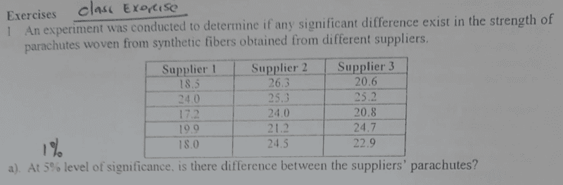

See attached
stats
Handwritten 'class Exercise' heading above a printed problem with a table of parachute strength values for three suppliers: Supplier 1, Supplier 2 and Supplier 3, with five values each, followed by the question about significance at the 5% level.
Kindly note that i do not have the solution or mark scheme to this question.
My take on this,
From stats...my points are in summary... ( am assuming the reader is literate on this), we shall have;
##k=3, N=15##
##d.f.N=2##
##d.f.D=12##
##α=0.05##
The critical value = ##3.89##
Let ##H_0: μ_1=μ_2=μ_3##
##H_A: μ_1≠μ_2=μ_3## or ##μ_1=μ_2≠μ_3##
##X_{am}##= ##\dfrac{333.1}{15}##=##22.207##
Between Group Variance;
##S^2_B##=##\dfrac{5(19.52-22.207)^2+5(24.26-22.207)^2+5(22.84-22.207)^2}{2}##
=##\dfrac{36.099845+21.074045+2.003445}{2}=## ##\dfrac{59.177335}{2}##=##29.5886##
Within Group Variance;
##S^2_W##=##\dfrac{4(7.237+3.683+1.9062)}{12}##=##\dfrac{12.8262×4}{12}##=##4.2754##
##F##=##\dfrac{S^2_B}{S^2_W}##=##\dfrac{29.5886}{4.2754}##=##6.9266>3.89##
Conclusion;
We reject the Null Hypothesis and accept the Alternative Hypothesis that there is a difference between the supplier's parachutes.
Oops ! :wink:
##\dfrac{4(7.237+3.683+{\bf \color{red}{1.9062}})}{12}##
I have 4.553 there ...
BvU said:
Oops ! :wink:
true error there... It is supposed to be,
##\dfrac{18.212}{4}##
Let me amend last part here...no need to interfere with original post...to make it easier for viewers to follow;
##S^2_W##=##\dfrac{4(7.237+3.683+4.553)}{12}##=##\dfrac{15.473×4}{12}##=##5.1576666##
##F##=##\dfrac{S^2_B}{S^2_W}##=##\dfrac{29.5886}{5.1576666}##=##5.73681>3.89##
Conclusion;

Explain why your alternative hypothesis is as given. That is not the opposite of ##\mu_1=\mu _2=\mu _3##.
I may need your input there...i tried to follow literature on such like questions, should it be
##H_A: μ_1≠μ_2≠μ_3##
The setup is as follows. You start with your initial hypothesis. If that turns out to be false with some level of confidence, then the opposite statement is accepted. In this case the null hypothesis is: ##\mu _1 = \mu _2## and ##\mu _2=\mu _3## and ##\mu _1=\mu _3## (it is redundant to write it like this, but it makes what follows clearer). The alternative is the negation, which is
[tex] \mu _1\neq \mu _2 \quad\mathrm{or}\quad \mu _2\neq\mu _3\quad\mathrm{or}\quad \mu_1\neq \mu _3.[/tex]

##\mu _1 \neq \mu _2 \neq \mu _3## is read as
[tex] \mu _1\neq \mu _2 \quad\mathrm{and}\quad \mu _2\neq \mu _3,[/tex]
which is not equivalent to what I wrote. This is not debatable. If your work is sloppy, your results are sloppy/incorrect.
