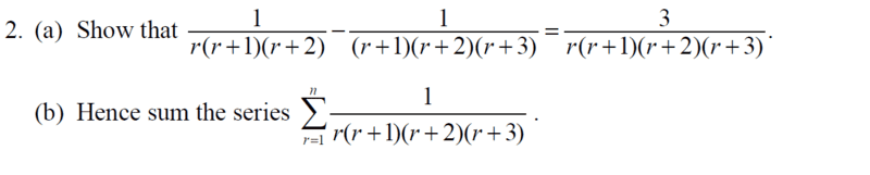

Show that ##\dfrac{1}{r(r+1)(r+2)} -\dfrac{1}{(r+1)(r+2)(r+3)}= \dfrac{3}{r(r+1)(r+2)(r+3)}##; hence sum the series ## \sum_{r=1}^n \dfrac{1}{r(r+1)(r+2)(r+3)}##
Method of difference
Attempt;
##\dfrac{1}{r(r+1)(r+2)} -\dfrac{1}{(r+1)(r+2)(r+3)}=\dfrac{(r+3)-1(r)}{r(r+1)(r+2)(r+3)}=\dfrac{3}{r(r+1)(r+2)(r+3)}##
Let ##f(r)=\dfrac{1}{r(r+1)(r+2)}##
##f(r+1)= \dfrac{1}{(r+1)(r+2)(r+3)}##
Therefore ##\dfrac{3}{r(r+1)(r+2)(r+3)}## is of the form ##f(r)-f(r+1)##
When ##r=1## we have
##\left[\dfrac{1}{6}- \dfrac{1}{24}\right]##
When ##r=2## we have
##\left[\dfrac{1}{24}- \dfrac{1}{60}\right]##
When ##r=3## we have
##\left[\dfrac{1}{60}- \dfrac{1}{120}\right]##
When ##r=n## we shall have
##\dfrac{1}{n(n+1)(n+2)}- \dfrac{1}{(n+1)(n+2)(n+3)}##
Therefore;
##3\sum_{r=1}^n \dfrac{1}{r(r+1)(r+2)(r+3)}=\left[\dfrac{1}{6}-\dfrac{1}{(n+1)(n+2)(n+3)}\right]##
##\sum_{r=1}^n \dfrac{1}{r(r+1)(r+2)(r+3)}=\left[\dfrac{1}{18}-\dfrac{1}{3(n+1)(n+2)(n+3)}\right]##
Your insight welcome...refreshing on this today...
Looks good. But rather than working out the numerical values for a few early terms, a more ‘formal’ proof might be something like this:
Let ##g(r) = \frac 3{r(r+1)(r+2)(r+3)}##. You have already defined ##f(r)## and established that ##g(r) = f(r) – f(r+1)##.
##\begin {flalign*}
\sum_{r=1}^n g(r)
&= \sum_{r=1}^n (f(r)-f(r+1))\\
&= f(1)-f(2)+f(2)-f(3)+f(3)-f(4)...+f(n)-f(n+1)\\
&= f(1)-f(n+1)\\
\end {flalign*}##
etc.
