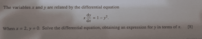

See attached
understanding of integration and separation of variables.
This is the question;
This is the solution;
Find my approach here,
##x####\frac {dy}{dx}##=##1-y^2##
→##\frac {dx}{x}##=##\frac {dy}{1-y^2}##
I let ##u=1-y^2## → ##du=-2ydy##, therefore;
##\int ####\frac {dx}{x}##=##\int ####\frac {du}{-2yu}##, we know that ##y##=##\sqrt {1-u}##
##\int ####\frac {dx}{x}##=##\int ####\frac {du}{-2u\sqrt {1-u}}## i let,
##\frac {1}{u\sqrt {1-u}}##=##\frac {A}{\sqrt {1-u}}##+##\frac {B}{u}##
→##1=##Au##+##B##\sqrt {1-u}##
##A=0.5## and ##B=0.5## * i need to check how to arrive at this...i got a bit stuck here...

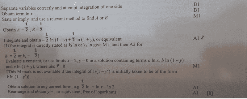

Hello @chwala !
Your marking scheme wants separation of variables. I empathically suggest you try that: all ##y ## stuff on the left and all ##x## stuff on the right !
Then @anuttarasammyak's giveaway should help you integrate both sides.

Ok from this step, i have
##\int ####\frac {dx}{x}##=##\int ####\frac {dy}{({1+y})({1-y})}##
Let, ##\frac {1}{({1+y})({1-y})}##=##\frac {A}{1-y}##+##\frac {B}{1+y}##
##1=A(1+y)+B(1-y)##
→We get the simultaneous equation,
##A+B=1##
##A-B=0##
##A=0.5## and ##B=0.5## therefore we shall have
##\int ####\frac {dx}{x}##=##\int ####\frac {0.5dy}{1-y}##+##\int ####\frac {0.5dy}{1+y}##
...on integration we get,
##\frac {1}{2}####ln|1+y|####-\frac {1}{2}####ln|1-y|##=##ln|x|##+##k##
on applying ##y(2)=0##,
we get ##k##=##-ln|2|## therefore,
##\frac {1}{2}####ln|1+y|####-\frac {1}{2}####ln|1-y|##=##ln|x|####-ln|2|##
##\frac {1}{2}####ln####\frac {|1+y|}{|1-y|}##=##ln####\frac {|x|}{|2|}##→
→...##\frac {1+y}{1-y}##=##\frac {x^2}{4}##
##4y+x^2y=x^2-4##
##y(4+x^2)=x^2-4##
##y##=##\frac {x^2-4}{x^2+4}##

and, sure enough, once things are put back on the rails, your proceed well, up to
$$ {{1+y}\over {1-y}} = {x^2\over 4}$$ where a new derailing occurs ...
Likes chwala
The result is now impeccable ! Scrap the last part of #10 !
$$y=\frac {x^2-4}{x^x+4}$$:partytime:Bingo !:partytime:
