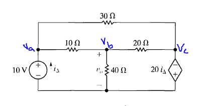

Circuit schematic with nodes labeled Va, Vb and Vc; 10 V source, resistors 30 Ω, 10 Ω, 20 Ω and 40 Ω, and a dependent voltage source labeled 20iΔ.
I'm asked to solve for Vo for this equation. I've set the bottom node to be my reference node before applying nodal analysis. When included in the KCL equation for node at Vb, will the dependent voltage source 20iΔ be negative since the current through that element is leaving node C?
Say, the equation would be: [(Vb-10v)/10Ω]+ (Vb/40Ω)+[(Vb+20iΔ)/20Ω]=0
Thanks!
–20iΔ is the voltage Vc
(typo corrected)
I see Va, Vb, Vc labeled, but no Vo label. Which voltage are you supposed to solve for? Thanks.
berkeman said:
Welcome to the PF.
Vo = Vb, labeled across the 40ohm resistor.
Your equation looks good to me. The voltage at node Vc is negative because of the polarity of the dependent source, as labeled in the schematic.
