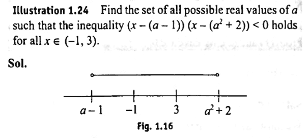

Find the set of all possible real values of ##a## such that the inequality ##(x-(a-1))(x-(a^2+2))<0## holds for all ##x \in (-1,3)##
If ##\boldsymbol{(x-a)(x-b)<0\Rightarrow x \in (a,b)}##, where ##a<b##. We remember that the "interval" ##(a,b)## stands for the set of all real numbers ##x## such that ##a < x < b##.
Problem statement :
Let me copy and paste the problem as it appears in the text.

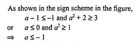

Attempt : From the "Relevant Equations" given above, we can compare to see that ##a-1 = -1## and ##a^2+2=3##. These lead (after some algebra) to the three values of ##\boxed{a=0, \pm 1}##.
Issue : The book has a different answer. It says ##\boxed{a\le -1}##.
Book's solution : I copy and paste the solution given in the book below.
Doubt : Besides not following the solution in the text, let's investigate its answer to the problem, viz. ##\boxed{a\le -1}##. So let me take a value of ##a##, say ##a=-3##. That would make the inequality read ##(x+4)(x-11)<0##. This would lead to the following interval for ##x \in (-4,11)##, clearly different from the given interval [##x \in (-1,3)##].
Is the book mistaken? A hint or a suggestion would be welcome.

If we take ##a = 0## (one of your solutions), then we need:
$$\forall x \in (-1, 3): (x+1)(x-2) < 0 $$This fails for ##x = 2.5##, say. So ##a=0## is not a solution.
Likewise for ##a = 1## we need:
$$\forall x \in (-1, 3): (x)(x-3) < 0 $$This fails for ##x = 0##, say. So ##a=1## is not a solution.
For ##a = -1## we need:
$$\forall x \in (-1, 3): (x+2)(x-3) < 0 $$The inequality holds on that interval. So ##a=-1## is a solution.
The interval ##(-4, 11)## contains the interval ##(-1, 3)##, so the inequality holds on this interval. As required. The question does not require that the inequality holds only on the specified interval.

You cannot require both [itex]a -1 = -1[/itex] and [itex]a^2 + 2 = 3[/itex]: The first requires [itex]a = 0[/itex], the second requires [itex]a = \pm 1[/itex]. You do not get three possible values for [itex]a[/itex] from these conditions; you get zero possible values of [itex]a[/itex].
So in fact there is no choice of [itex]a[/itex] for which [itex](x - (a-1))(x - (a^2 + 2)) < 0[/itex] holds only for [itex]x \in (-1,3)[/itex] and not otherwise; the book's solution that [itex]a[/itex] must satisfy both [itex]a - 1 \leq -1[/itex] and [itex]a^2 + 2 \geq 3[/itex] and the inequality hold for some larger interval (which cannot be made smaller than (-2,3) when [itex]a = -1[/itex]) is correct.

What made my given problem above in post# 1 a bit tricky is that there was apparently "two" intervals, one in the variable ##a## [##(a-1, a^2+2)##] and another in integers [##(-1,3)##]. A student might equate them, as I did. Doing so however gave wrong answers for the value of ##a##. The trick is to realize that the interval given by variable ##a## includes that given with the integers.
