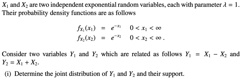

Okay thank you for the reply @PeroK . The answer reads:
"Firstly we know that:
[tex]0 < y_1 + y_2 < \infty[/tex]
[tex]0 < y_2 - y_1 < \infty[/tex]
This can be re-written as:
[tex]-y_2 < y_1 < y_2[/tex]
[tex]0 < y_2 < \infty[/tex] "
So not the most descriptive solution... Also, the wider problem was this (shown in image below), but it was only the "finding the support of y1 and y2" part I was struggling with - I am not sure if that helps to provide more context.
Typeset problem statement: X1 and X2 are independent exponential random variables with parameter lambda = 1, with densities e^(-x1) for 0 < x1 < infinity and e^(-x2) for 0 < x2 < infinity. Y1 = X1 - X2 and Y2 = X1 + X2; part (i) asks for the joint distribution of Y1 and Y2 and their support.
