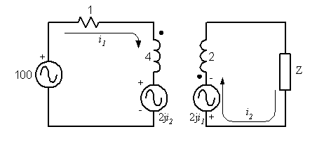

When I apply the equations in phasor domain V1=jω(L1)(I1)±jωM(I2) and
V2=jω(L2)(I2)±jωM(I1) and then mesh analysis should I consider the other mesh on the far right side with the capacitor? In other words, this is the first problem that I've seen or had such as this and since I2 is a combination of that mesh and I3 then I'm tempted to add that mesh, but I'm unsure if doing that is the correct way to go, I don't have the answer to the problem to go back and check my work against it. I thought about going into Multisim and trying to get an approximate answer to check my work against. I'm stuck...
Thanks for your help and any advisement...
See the attached file for problem statement, given, and what to find.
I've found the maximum mutual inductance to be 2√2 H and I've found the coupling coefficient to be 0.707.

Yes, you need to write mesh equations for all three loops. Consider that the all of the components on the right hand side form the load for a transformer.
Although, if you wanted to you could combine the resistors and capacitor into a single impedance. That way you'd reduce the circuit to two loops.
Thanks for your help. Okay, so combining the loops I2 and I3 I have the 2Ω resistor and -j2Ω in series and then in parallel with the 2Ω resistor which totals (1.2-j0.4)Ω in place of the original 2Ω resistor and now that give me the following mesh equations to solve:
For I1: I1(1+j4)-j2I2=100 then
For I2: I1J2+I2(-1.2+j2.4)=0
Then solve for I1 and I2, correct?
Your impedance looks good, but I think you need to pay attention to dot notation on the inductors when you go to write your loop equations; it affects the polarities of the equivalent voltage sources representing the mutual inductance.

I'm seeing values closer to 30 A in magnitude for both currents. Can you write out your two mesh equations (where the resistors and capacitor have been reduced to a single impedance)?
(1+j4)I1-j2I2=100 In the Primary
j2I1+(-1.2+j2.4)I2=0 In the Secondary

Ah, you see, I'm finding +j2I2 in the first equation. The induced voltage in the primary due to i2 represents a potential drop for the "KVL walk" in the direction of i1.

I initially have 100-1I1-j4I1+j2I2=0 and then I consolidate and move everything on one side except for the 100 and solve simultaneously...should I rearrange my equation?
The potential change across the mutual inductance source goes from + to -, so it's a drop just like the change across the resistor is a drop. They should have the same sign.

Again, that's not what I'm seeing. Let's see your two mesh equations again.
After changing that induced value in the primary I have:
(1+j4)I1+j2I2=100 and
J2I1+(-1.2+j2.4)I2=0
Thanks again for all of the work that you have put into helping me.
Okay, I like the first equation, not so much the second. For the secondary circuit, you've combined the two resistors and the capacitor into a single impedance. So (assuming units of Ohms), that's 2 || (2 - 2j). That yields (6/5) - (2/5)j. So the total impedance in the loop seen by I2 is then
##2j + \frac{6}{5} - \frac{2}{5}j = \frac{6}{5} + \frac{8}{5}j##
That should make your second equation look like:
##2 I_1 j + \left(\frac{6}{5} + \frac{8}{5} j \right) I_2 = 0 ##

Okay, for the grand finale:
I1=30.71∠-47.49° A
I2=30.71∠169.38° A
Thanks a ton for all of your help and for not letting me drown out in the open ocean, LOL. I can see that I would have gotten the incorrect answer anyways even if my equations were correct to begin with. I had errors in my equation that you had pointed aut and errors in adding my rectangular coordinates by adding j2 to (1.2-j0.4) and just added the j2 to a positive j0.4, wrong no matter how I look at it. Thanks a lot!
