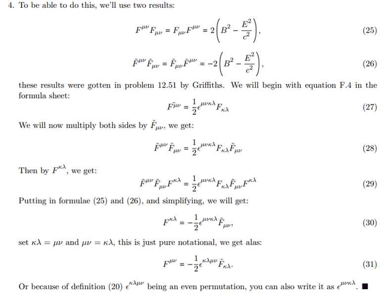

Expressing the field tensor in terms of the four dimensional Levi-Civita symbol and covariant dual field tensor.
See solution.
Exercise:
Text problem: Write down an expression for F^{μν} in terms of the dual tensor ĀF_{μν} and the epsilon^{μνλσ} tensor. Note: it is possible to work out this part avoiding nasty calculations.
Solution:
Typeset derivation of equations (25) to (31) for contracted electromagnetic field tensors, using Levi-Civita epsilon identities and index relabelling.
The result is correct, but I'm unsure about equation from 29 to 30 where right-hand side became just the covariant dual field tensor. I assumed that I could interchange the covariant dual- and normal covariant field tensor, but don't think it's possible since matrices aren't commutative.
I think I bruteforced to get the correct result.:cool::headbang::angel::eynman:
P.S: definition (20) is just the definition of the four-dimensional Levi-Civita symbol.
You can interchange F and its dual in the conteaction. You're adding (products of) components, which commute. You don't multiply whole matrices.
Btw, you should then also worry about those implicit metric tensor "matrices" in the contraction of F with itself.
Wow, thx!

From
(29)\qquad \color{red}{\tilde{F}^{\mu \nu} \tilde{F}_{\mu \nu}} F^{\kappa \lambda}=\frac{1}{2} \epsilon^{\mu \nu \kappa \lambda} \color{blue}{F_{\kappa \lambda}} \tilde{F}_{\mu \nu} \color{blue}{F^{\kappa \lambda}}
which can be rewritten (using tensorial methods) as
(29)\qquad \color{red}{\tilde{F}^{\mu \nu} \tilde{F}_{\mu \nu}} F^{\kappa \lambda}=\frac{1}{2} \epsilon^{\mu \nu \kappa \lambda} \tilde{F}_{\mu \nu} \color{blue}{F_{\kappa \lambda}} \color{blue}{F^{\kappa \lambda}}
##inserting
(26)\qquad \color{red}{\tilde{F}^{\mu \nu} \tilde{F}_{\mu \nu}}=-2\left(B^2-\frac{E^2}{c^2}\right)
(25)\qquad \color{blue}{F_{\kappa \lambda} F^{\kappa \lambda}}=2\left(B^2-\frac{E^2}{c^2}\right)
you get
\color{red}{-2\left(B^2-\frac{E^2}{c^2}\right)} F^{\kappa \lambda}=\frac{1}{2} \epsilon^{\mu \nu \kappa \lambda} \tilde{F}_{\mu \nu} \ \color{blue}{2\left(B^2-\frac{E^2}{c^2}\right)}
\color{red}{-1} F^{\kappa \lambda}=\frac{1}{2} \epsilon^{\mu \nu \kappa \lambda} \tilde{F}_{\mu \nu}
which is equal to "minus Eq. (30)"

The next step in post #1 is
Equation (29): F-tilde mu nu times F-tilde sub mu nu times F superscript kappa lambda equals one half epsilon superscript mu nu kappa lambda times F sub kappa lambda times F-tilde sub mu nu times F superscript kappa lambda.
Here, we have confusion. The ##\kappa## and ##\lambda## indices appear alone on the left side. So, these indices are not being summed on the left side. Going from left to right on the right side of (29), we know that the first two ##\kappa##'s are summation indices. But, the ##\kappa## in the last factor, ##F^{\kappa \lambda}##, is not suummed since this ##\kappa## corresponds to the ##\kappa## on the left side of the equation. The same remarks can be made for the ##\lambda##'s in (29).
Note that (29) can be written with less confusion as
$$\tilde{F}^{\mu \nu} \tilde{F}_{\mu \nu} F^{\kappa \lambda}= \frac 1 2 \epsilon^{\mu \nu \alpha \beta}F_{\alpha \beta} \tilde{F}_{\mu \nu} F^{\kappa \lambda} $$
Here, it is clear that ##\mu##, ##\nu##, ##\alpha##, and ##\beta## are summation indices while the ##\kappa## and ##\lambda## are fixed indices that are not summed. However, it doesn't appear to me that this equation is very helpful in getting to the result of expressing ##F^{\mu \nu}## in terms of ##\tilde{F}_{\mu \nu}## and the Levi-Civita tensor.
A better approach is to follow @vanhees71. Start with $$\tilde{F}^{\alpha \beta} = \frac 1 2 \epsilon^{\alpha \beta \kappa \lambda}F_{\kappa \lambda} $$ Raise and lower indices to write this as $$\tilde{F}_{\alpha \beta} = \frac 1 2 \epsilon_{\alpha \beta \kappa \lambda}F^{\kappa \lambda} $$ Multiply both sides by ##\epsilon^{\mu \nu \alpha \beta}## and sum over ##\alpha## and ##\beta##. $$\epsilon^{\mu \nu \alpha \beta} \tilde{F}_{\alpha \beta} = \frac 1 2 \epsilon^{\mu \nu \alpha \beta} \epsilon_{\alpha \beta \kappa \lambda}F^{\kappa \lambda} $$ Proceed by using identities (A.4.5) and (A.3.1) in the appendices of https://itp.uni-frankfurt.de/~hees/pf-faq/srt.pdf. It is helpful to note that ##\epsilon_{\alpha \beta \kappa \lambda} = \epsilon_{ \kappa \lambda \alpha \beta}##.
