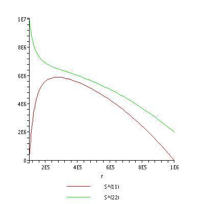

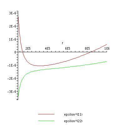

12. EXAMPLES OF STATIC EQUILIBRIUM: Addendum
EXAMPLE FIVE POINT FIVE: Consider an isolated spherical ball with a cavity at the center, with radii [itex]0 < R_1 < R_2[/itex], which is made of a homogeneous isotropic material and deformed by its own weight. Naturally we will once again use the polar spherical chart with frame field
[tex] \vec{e}_1 = \partial_r, \; <br /> \vec{e}_2 = \frac{1}{r} \, \partial_\theta, \;<br /> \vec{e}_3 = \frac{1}{r \, \sin(\theta)} \, \partial_\phi[/tex]
To get started, we need to first compute the body force inside the body (or rather, the acceleration of a bit of the body by this force). That is, we need to compute the (divergence of the) Newtonian gravitational potential [itex]\Phi[/itex] for a spherically symmetric object with constant density and with a cavity at the center. The potential is harmonic in the exterior (vacuum solution in Newtonian gravitation!) and satisfies the Poisson equation
[tex] \Delta \Phi = 4 \pi \, G \, \rho[/tex]
in the interior of the body. It is spherically symmetric, so we write
[tex] \Phi_{rr} + \frac{2 \, \Phi_r}{r} = 4 \pi \, G \, \rho[/tex]
in the interior and
[tex] \Phi_{rr} + \frac{2 \, \Phi_r}{r} = 0[/tex]
in the exterior. Solving, we obtain a piecewise defined function with six undetermined constants (two for each of the three pieces). To determine these we demand that the potential should be continuously differentiable, and that it should approach zero as [itex]r \rightarrow \infty[/itex]. The result is an everywhere negative potential function which is constant on [itex]0 < r < R_1[/itex], bends up on [itex]R_1 < r < R_2[/itex], and then, on [itex]R_2 < r < \infty[/itex], bends over and approaches the real axis from below as [itex]r \rightarrow \infty[/itex]. Differentiating this with respect to r and reversing the sign, we obtain the gravitational acceleration which inside the body turns out to be
[tex] \vec{a} = <br /> -g \, \frac{R_2^2}{r^2} \, \frac{r^3-R_1^3}{R_2^3-R_1^3} \, \vec{e}_1[/tex]
where [itex]g = G \, M/R_2^2[/itex] is the surface gravity and
[tex] M = \frac{4 \pi \, \rho}{3} \; \left(R_2^3 - R_1^3 \right)[/tex]
is the mass of the body. Notice that in the special case [itex]R_1=0, \, R_2=R[/itex] this reduces to
[tex] M= \frac{4 \pi \, \rho}{3} \; R^3, \;<br /> g = \frac{G \, M}{R^2}, \;<br /> \vec{a}=-g \, \frac{r}{R}[/tex]
which was the previous example.
Now we assume that the displacement vector [itex]\vec{U} = f(r) \, \vec{e}_1[/itex] is purely radial and plug in the body acceleration into our equilibrium condition. This gives f in terms of two undetermined constants. But our boundary conditions stipulate that the component [itex]S^{11}[/itex] must vanish on the inner and outer surfaces, so plugging in [itex]r=R_1,\, R_2[/itex] we obtain a unique displacement vector and thus a unique strain and stress tensor. It is interesting and instructive to plug in some numbers because the behavior of the elastic variables vary in interesting ways.
Exercise: In the early years of UseNet, someone named Robert E. McElwaine used to very frequently post statements to the effect that the Earth is actually hollow, that this "fact" was discovered by polar explorer Richard E. Byrd, because (said McElwaine) the polar ice caps do not exist! According to McElwaine, the polar regions actually consist of two huge holes leading into the interior cavity. (No kidding! See http://www.popmartian.com/mcelwaine/ for a hoot.) Furthermore (he claimed), this "fact" has been covered up ever since because... well, I don't think he ever explained the alleged motivation of this dark conspiracy. :wink: Anyway, inspired by the challenge of quickly assessing the (im)-plausibility of the implicit assumption that such a structure is even physically possible, and bearing in mind that steel is much stronger than rock, imagine a huge steel ball with a concentric spherical cavity, with the same mass and external radius as the Earth. (Note that the density of steel exceeds the average density of the Earth, so these conditions must determine a positive inner radius.) Does this object--- let's call it Mgeni--- have nearly the same surface gravity as Earth? Using the values given in an earlier section for the material parameters of structural steel
[tex] \rho = 7.91 \, {\rm gm}/{\rm cm}^3, \; <br /> E = 19.6 \times 10^{11} \, {\rm dyn}/{\rm cm}^2, \; <br /> \nu = 0.30[/tex]
compute the displacement vector and strain tensor. Assuming the elastic limit of steel is approximately [itex]10^{-3}[/itex], does the strain appear reasonable? Compute the putative stress tensor. Where does the maximum stress occur? One Earth atmosphere is about [itex]1.1013 \times 10^6 \, {\rm dyn}/{\rm cm}^2[/itex]. What is the maximum stress in atmospheres? According to some unknown writer in "the most massive thing often called an encyclopedia" (to paraphrase Larry Sanger http://www.edge.org/3rd_culture/sanger07/sanger07_index.html), namely the Wikipedia :rolleyes: the typical internal pressure in a container of bottled gas might be as high as 400 atmospheres. What does this comparison suggest? Can Mgeni exist?
Exercise: plug in the material parameters for structural steel with [itex]R_1=1 {\rm km}, \; R_2 = 10 {\rm km}[/itex] and plot the radial displacement, strain components, and stress components. What feature of the radial strain do you notice? Are these strains and stresses reasonable? Can you modify this model so that the ball is spinning about some axis with constant angular velocity? (The new body force will combine gravitational and centrifugal forces.)
