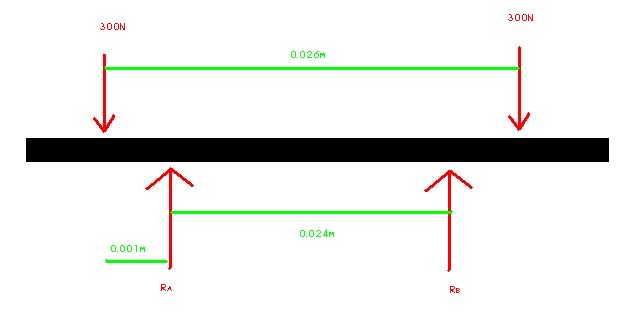

Hi there all,
I am designing a pedal box for a vehicle, and its adjustment is does by removing some pit-pins and sliding the pedal box along a rail and reinserting the pins. I need to calculate the stresses in the pin given a 600N total load applied by the feet of the driver. The pin is of radius 3.5mm, and has a Youngs Modulus of 193GPa.
Free-body diagram of a beam with two downward 300N point loads near each end, upward reaction forces RA and RB under the beam, spacing labelled 0.026m, 0.024m and 0.001m.
That diagram basically shows what is happening after i have simplified the problem. The beam is not supported at the ends. The black part is the pin, or beam, and where the loads and reactions are are where the pin is in contact with the chassis/pedal box.
I am trying to work through this website:
http://www.engineersedge.com/beam_bending/beam_bending7.htm
but can not get any decent answers. I am not too sure what dimensions u, x and c are to be honest.
I make the Moment of Inertia to be 1.18 x 10^-10 .
Working through a mechanics book i get the ractant forces to be 300N, and a shear force diagram that goes 300N-0N--300N along the length of the beam, which i can't help but think is wrong. I was expecting a more complex outcome to be honest.
Any help wold be much appreciated as this is making me feel very stupid!
TowlieUK, welcome to PF!
c is the overhang distance 0.001 m; u is the distance between the support and the point of interest where you wish to calculate the stress, measured from the support toward the near free end.
yes
you were expecting too much, your shear force diagram is correct. What is the maximum bending stress in the pin?
