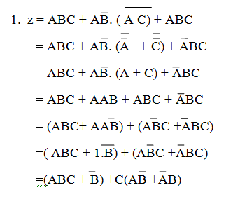

adnankhuram Messages 3 Reaction score 0 Thread starter Dec 6, 2011 #1 Am i doing right? And what to do next? Attachments 2.PNG 2.2 KB · Views: 470
Ivan92 Messages 201 Reaction score 3 Dec 7, 2011 #2 This looks right. The last 2 terms would produce an EXOR operation. Remember: [tex]A'B+AB' = A\oplus B[/tex] Nothing else comes to mind when simplifying this further. However you can refer to the attachment if there is anything else you can do. Attachments boolean_algebra.pdf boolean_algebra.pdf 10.9 KB · Views: 320

Joffan Messages 473 Reaction score 13 Dec 7, 2011 #3 [itex]AA = 1[/itex] is not correct. And there seem to be other possibilities at the top line - consider what is [itex]ABC + \bar{A}BC[/itex] ?

Joffan Messages 473 Reaction score 13 Dec 8, 2011 #5 Let me encourage a little further and say that I agree with your work until the fourth line, adnankhuram. From there you can make further simplifications to leave something that looks like [itex]PQ+RS[/itex].
