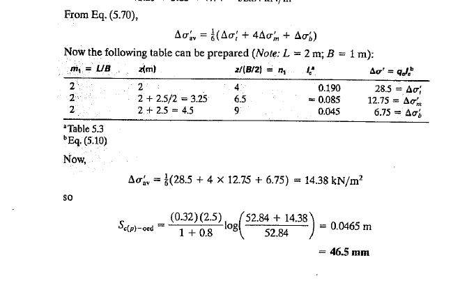

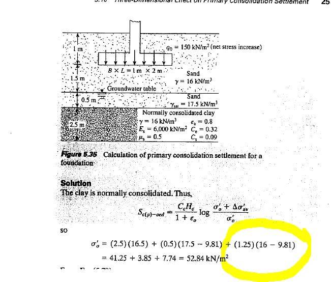

I don't understand why the pressure before the construction of foundation is given by (2.5)(16.5) + (0.5)(17.5-9.81) +(1.25)(16-9.81) only ?. Why the pressure is taken only to the half of the layer of clay only ?
I think it's wrong , it should be (2.5)(16.5) + (0.5)(17.5-9.81) +[/B](2.5)(16-9.81) ..Correct me if I am wrong

  • Cross-section diagram of a foundation on layered soil: a 1 m by 2 m footing with a 150 kN/m² net stress increase, over 1.5 m of sand, a groundwater table, 0.5 m of saturated sand, and 2.5 m of normally consolidated clay with listed properties; the solution's effective stress calculation is highlighted.

  • Handwritten-style worked calculation of consolidation settlement: Eq. (5.70) average stress, a table of m1, z/(B/2), I values and delta sigma values, then delta sigma av = 14.38 kN/m^2 and S = 46.5 mm.
Anyone has answer ? I seriously think it's wrong. Can anyone guide me ? Thanks in advance !
