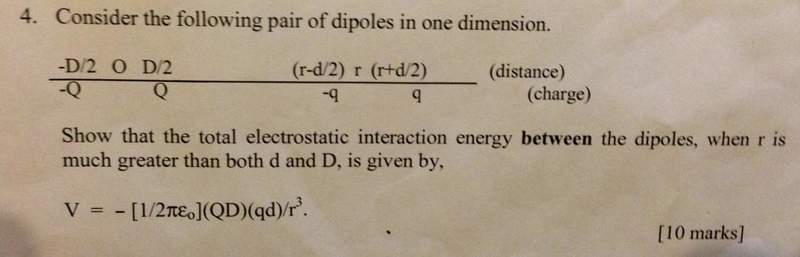

See attachment
Thus far I believe I am supposed to use calculate the interaction with kQq/Δr? I have tried summing over interactions so that 1/4∏ε*[(-Q)(-q)/(r-d/2+D/2) + (-Q)(q)/(r+d/2+D/2) + (Q)(-q)/(r-d/2-D/2) + (Q)(q)/(r+d/2-D/2)] , but this doesn't work, could someone point me in the right direction.

With taylor series for those factors of 1/(r+d/2) and similar (and assuming d/2 << r), you should get the correct result.

Ok, thanks, is kQq/Δr the correct expression for the interaction energy between 2 charges, and more importantly is that what I'm supposed to be using? Because if so I don't see how I get any 1/(r-d/2) terms, I just get stuff like 1/(r-d/2+D/2) unless I neglect the D/2 because r >> D?
This is correct.
And right, you do not get "exactly" 1/(r+d/2), but you get similar expressions.
Ok thanks for the help, I can't seem to figure out what point I'm supposed to be taylor expanding about? For instance for the interaction between -Q and -q, 1/4∏ε*[(-Q)(-q)/(r-d/2+D/2)] take r = 1/(r-d/2+D/2) and that r >> D & d, d/2 vanish & D/2 vanish? Then I am just left with 1/r, bit confused, even if i try to expand that without making the approximation mentioned I still am not quite sure about what point I am expanding about.
The difference between 1/r and your terms is the point of the expansion.
$$\frac{1}{r+x} = \frac{1}{r} \cdot \frac{1}{1+\frac{x}{r}} \approx \frac{1}{r} (1 \pm \dots)$$

Yeh I got that bit but I mean if f(x) = 1/r * 1/(1 + x/r) and this expands to 1/r [f(a) + f'(a)(x-a) . . .] what is "a" supposed to be?
That is the point where you develop your taylor expansion. It depends on the definition of the f you choose, but I would expect 1 there.

Sorry I think I'm confused because I'm not entirely sure what the point is I'm developing the taylor expansion from, because if r = (r-d/2+D/2) that's over a length not a point :S? so kQq/(r-d/2+D/2) where i take f(x) = 1/r*(1/(1-x/r)) where x = d/2-D/2, still can't see what the point I'm expanding about is? Is it a=d/2 or a=D/2 or even a=r? so f(x) ≈ 1/r*[1/(1-a/r) + 1/r*(1/(1-a/r)2)*(x-a)] but so confused about the a :(.
You're expanding about x/r = 0. To be a bit more explicit, the function you're expanding is ##f(z) = \frac{1}{1-z}## about ##z=0## and then plugging in ##z=x/r##.

Actually I just tried that and my expansion ≈ 1/r + (d/2 + D/2)/r^2, then i tried for the remainder terms and the final result came to (2rQq - 2rQq)/r^2 = 0, i imagine my expansion came out wrong, is it wrong?
Nope, that's fine. If you look at the result you're trying to arrive at, you should notice it has r3 on the bottom, so you want the 1/r and 1/r2 terms to cancel out.
