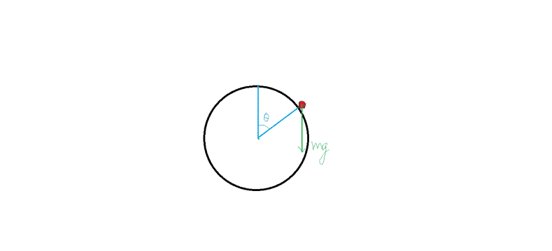

1/2 mv^2 = mgh
first, a side question, if p = mv, can't we just place p into 1/2 mv^2 so it becomes 1/2 p^2?
anyway, on to the question, at the point where the cube falls off, the Fnormal should just about equal 0, correct?
is this the way to approach the problem? Or we can find the velocity where the cube loses contact with the sphere and plug that v into 1/2 mv^2 = mgh, solving for h.

When the ball will freely fall then it's total acceleration will be ##g##. You just need here radial acceleration.
If the block looses contact with the sphere then what can you say about the magnitude of Normal reaction force acting on the block.
If the block has velocity at ##v## at the instant shown then what should be the centripetal force acting on it? This centripetal force it provided by which force? Equate them and get the answer.

Yes Normal force will be zero when it looses contact. But centripetal force is provided by the component of mg. Can you find it?

I said a ##component## of mg. Can you find it in terms of mg and ##\theta##?
it should be the hypotenuse in the picture, which is mg / cos theta
how do we solve for theta?

It will be ##mgcos\theta##
First equate this to centripetal force. You can find relation between ##v## and ##\theta## by conservation of energy.

mgcosθ = m v^2 / rgcosθ = v^2/r

Yes. Now use conservation of energy to find relation between v and theta.

What is the initial velocity of the block?
Can you represent hi and hf in terms of R and theta?

hf is ##Rcos\theta##. Now proceed.

##h_{f}=Rcos\theta##. Put this in energy equation. You would have two unknowns v and ##\theta##. Remember the equation which you made by using centripetal force. Use these two equation and find ##\theta##.:smile:

I think you have done some mistake. The equations are
##2mgR(1-cos\theta)=mv^{2}##
and ##Rgcos\theta=v^{2}##
Find ##\theta##. You don't have to find v.

angle should be 48 degrees

Yes ##cos\theta=\frac{2}{3}##. From this can you find the height above which it looses contact with the ball?

6.89 m
