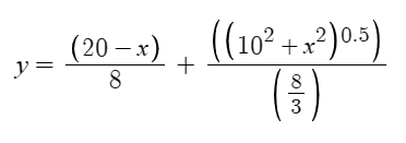

I've solved this problem on IP by writing the relevant equations into Gsheets and solving through trial and error. I've followed their hints for solving it, which lead me to a rather complex quadratic to solve. I'd appreciate if anyone can give me a clue as to how to solve for x in the following:
0 = -1/8 + 3/8 x / (10^2 +x^2)^0.5
The logic behind that is that the total time will be given by:
If x is the distance from O to C, where C is the point along the beach that they stop running and begin swimming. The first term is the time taken to run to C, and the second to swim along the hypotenuse of triangle OBC.
Graphing this we can see a curve, where the minimum value is a point where the gradient is 0.
So differentiating and equating to zero, we get:
I'm fairly happy with all of that logic, and the value of x = 3.536m giving t = 6.035533909s checks out on IP and when input into the above equations, so I'm pretty sure my rearrangement and differentiation is OK.
So, it's just the last step, solving for x. I've tried rearranging and inputting into the quadratic formula, but I get a negative discriminant. I'd greatly appreciate anyone walking through that last step. My algebra is clearly rusty!
Or if you can see a different approach to reach the same solution, that would also be interesting. :)

Your overall method look good but have you differentiated correctly?
##t = \frac {20-x}8 + \frac 38 (100+x^2)^{0.5}##
I don’t thnk that gives:
##\frac {dt}{dx} = -\frac 18 + \frac 38 x (100+x^2)^{-0.5}##
(A factor of 2 missing?)
Also, t=6.035533909s (correct or not) is an answer precise to the nearest nanosecond (literally). You may wish to consider rounding!

That bit of differentiation was given in their hints:
And yes, 6.04s will do me just fine. :)

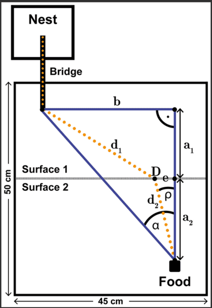

Refer to the figure below. We are looking for the path from point A in sand where the speed is ##v_1## to point B in water where the speed is ##v_2##. Let's assume that we have found the optimum point of crossing from sand to water and label it C. It divides the fixed horizontal displacement of the lifeguard into two segments ##x_1## and ##x_2##. The optimum time from A to B is $$T_o=T_{1o}+T_{2o}=\frac{\sqrt{d_1^2+x_1^2}}{v_1}+\frac{\sqrt{d_2^2+x_2^2}}{v_2}.$$
Now suppose we move the crossing point to, say, the left of point C by an amount ##\delta.## This will add ##\delta## to ##x_2## and subtract ##\delta## rom ##x_1##. The new total time will be longer and given by$$T=T_{1}+T_{2}=\frac{\sqrt{d_1^2+(x_1-\delta)^2}}{v_1}+\frac{\sqrt{d_2^2+(x_2+\delta)^2}}{v_2}.$$The difference between times on sand is $$\delta T_1=T_{1}-T_{1o}=\frac{1}{v_1}\left[\sqrt{d_1^2+(x_1-\delta)^2}-\sqrt{d_1^2+x_1^2}\right].$$Using the identity ##a-b=\dfrac{a^2-b^2}{a+b}##, we have $$\delta T_1=\frac{1}{v_1}\left[\frac{d_1^2+(x_1-\delta)^2-(d_1^2+x_1^2)}{\sqrt{d_1^2+(x_1-\delta)^2}+\sqrt{d_1^2+x_1^2}}\right]=\frac{1}{v_1}\left[\frac{-2x_1\delta+\delta^2}{\sqrt{d_1^2+(x_1-\delta)^2}+\sqrt{d_1^2+x_1^2}}\right].$$Up to this point the calculation is exact. For ##\delta << x_1## we approximate $$\delta T_1\approx\frac{-x_1\delta}{v_1\sqrt{d_1^2+x_1^2}}.$$Likewise we find $$\delta T_2\approx\frac{x_2\delta}{v_2\sqrt{d_2^2+x_2^2}}.$$ The path is optimized when a loss of time in one medium is compensated by a gain of time in the other, i.e. ##\delta T_1+\delta T_2=0.## Then
$$\frac{-x_1\delta}{v_1\sqrt{d_1^2+x_1^2}}+\frac{x_2\delta}{v_2\sqrt{d_2^2+x_2^2}}=0\implies \frac{\sin\theta_1}{v_1}=\frac{\sin\theta_2}{v_2}.$$

It seems that ants have some basic understanding of the lifeguard problem and Fermat's principle as reported here. That's what I thought initially, until I noted that the publication date on this piece is April 1, 2013. :wink:
Remarkably, the ‘ants obey Fermat’s principle’ may be genuine! The original article appears to have been published on the 20th March 2013: https://journals.plos.org/plosone/article/metrics?id=10.1371/journal.pone.0059739
