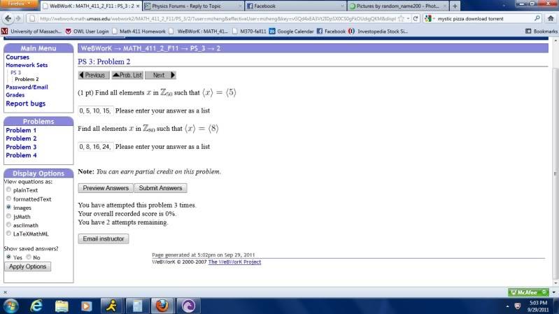

Find all elements x in Z50 such that <x> = <5>
none really
I thought <5> would be equal to {0, 5, 10, 15 ... 45} but that doesn't seem to be correct... can anyone tell me what I'm doing wrong?
Why doesn't it seem correct to you?? What you wrote is ok!
because i entered the answer in webwork and it says not correct :'( I'm so confuzzled.
Which answer did you enter?
Do note that 5 is not the only x that has <x> equal to the specified set.
I entered all the integers in the set like this: 0, 5, 10 etc. to 45.
i added a picture below. imagine the number going up to 45.
All right.
Let's consider x=10.
What is <10>?
Is it the same as {0, 5, 10, 15 ... 45}?
i'd say no to that.
but i don't really know how to tell which elements are reduplicates of each other.
just that <10> would be {0, 10, 20 etc.}
