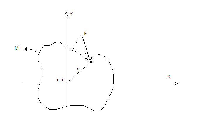

Given: mass m, moment of inertia I and a impulse applied at a distance x form the center of mass (c.m.).
Find the angular speed and the speed of the c.m.
[tex]\sum M_O = I \ddot{ \theta}[/tex][tex]F\Delta t = \sum m_i v_i[/tex]
I can solve for the acceleration but do I have to use a momentum balance to solve for angular speed?

Hi dirk_mec1! :smile:
(Do you mean acceleration? It's an impulse … the acceleration is taken to be irrelevant/infinite :confused:)
For the angular speed, find the torque of the impulse, then use the angular version of Newton's second law. :smile:

impulse
dirk_mec1 said:
But I presume you mean:
[tex]\sum M_O = I \ddot{ \theta} = I \omega^2 r[/tex]
right?
No … wrong formula … that's something like the formula for a continuous centripetal force making the centre of mass move in a large circle.
When the force ends, the circular motion stops!
This is an impulse, an instantaneous force, that makes the body spin on it own axis, with the centre of mass moving in a circle of radius zero.
When the force ends, the circular motion continues! :smile:
Newton's second law for impulses takes the forms:
impulse = momentum after minus momentum before;
torque of impulse = angular momentum after minus angular momentum before. :smile:

[tex]\mathbf{L}=\sum_i \mathbf{r}_i\times m_i \mathbf{V}_i[/tex]So if I understand you correctly the torque is :
[tex]F \Delta t \cdot x[/tex]
And how do I proceed?
(have a delta: ∆)
dirk_mec1 said:
So in formula form:
[tex]F \Delta t = \Delta p[/tex]
Yes and no …
F ∆t is correct, if you're given F (a force) and ∆t (a time interval).
But the question doesn't give you those …
it gives you an impulse …
let's call it P (for "I'm Pulse" :biggrin:) …
Then the formula is P = ∆p. :smile:
And the torque is Pxx

Well, that formula for angular momentum L is correct in principle (though you could have written it L = ∑ri x pi) …
but again you're not given the individual ri and pi
you're given the moment of inertia, I …
so L = … ? :smile:
and then ∆L = … ? :smile:

Well there´s another formule here in my book it reads:
[tex]\mathbf{L}= I \mathbf{\omega}[/tex]
Pxx?
Pxx?
Looks good! :smile:
So
[tex]Px=I \omega \rightarrow \omega = \frac{P \cdot x}{ I}[/tex]
right, Tim?
