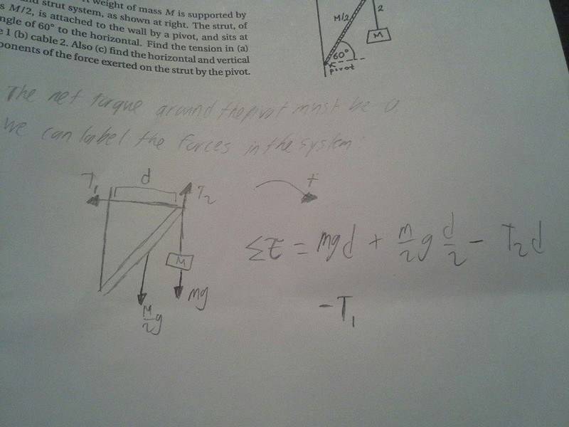

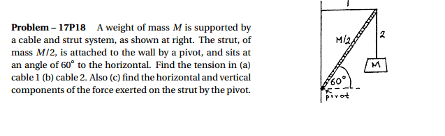

I really need help on walking through this problem...didn't really teach it in class...I tried watching a video and you're supposed to sum the forces * some perpendicular distance to the pivot? Yet what if the force is already perpendicular?
Check your force diagram for missing and incorrect forces acting on the beam.
T2 is the tension force acting on the mass m (eg not acting on the end of the beam).
Your equation has force T1 acting at what distance from the pivot? Let's say the beam has length L so d = Lcos(60). Then T1 acts at h where h= Lsin(60) from the pivot.
The net torque on the beam should sum to zero because it's not rotating.
The net forces in x and y on the beam should also sum to zero because it's not translating.

How does this look?

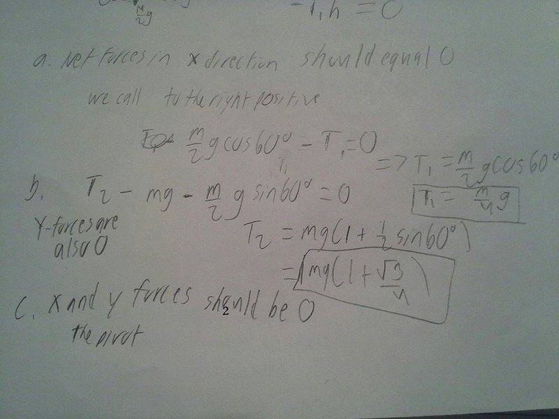

Also, how should I approach c? Is it just the weight of the beam?
What are the forces acting on the weight of mass M ?
There is a force on the beam at the pivot.

There is also a vertical force from the weight of the beam no? Which is M/2*G*sin60.
Also, how would I find the forces on the beam by the pivot?

No..that is not correct.The weight of the beam is acting on the beam ,not on the weight .There are only two forces acting on the weight ;T2 and Mg
So,what is the relation between them ?

Let us call the force exerted by pivot as P .The horizontal component as Px and vertical component as Py .
Can you write the torque equation for the beam with respect to the pivot ?

They are equal.
torque = px*sin60 + py*cos60 = 0?

Yes. So T2=Mg

Simply wrong .
The pivot force does not feature in the torque equation of the beam about the pivot . It would have played a role if we were writing torque equation about the center of mass .
List all the forces acting on the beam .

Just gravity?

It is only one of the forces acting on the beam .What about T1 and T2 ? Do you think any of them is acting on the beam ?

I apologize for my lack of knowledge and thank you so much for helping me.
I suppose T2 does pull the beam in the vertical direction and T1 pulls it in horizontal direction?
Yes...
So,basically there are four forces acting on the beam ; T1,T2,Mg/2 and P .
Do you agree ?
