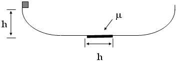

A block of mass m is initially held in place on the left side of a track at a distance h above the bottom of the track. The track is completely frictionless, with the exception of a rough horizontal section of track of length h which has a coefficient of kinetic friction μ = 0.11. If the block is released from rest, how many times does the block completely cross the rough section of track before it stops?

I know that the potential energy at the top is mgh, but other than that I'm lost. Could use some help.
  • Frictionless curved track with a block at the top of the left side, height h marked, and a rough horizontal section of length h labeled with coefficient μ.
No work is done on the block while the block is on the frictionless part of the track. So you can ignore these parts of the track. You can calculate how much work is done on the block as it passes through the friction patch from the work-energy theorem. Once you know how much energy is lost crossing the patch, you can figure out how many times the block could pass through the friction patch before it has no more energy. In the end, the block will be stuck in the friction patch but you can calculate how many times it went through it.

ok thanks, I got 9, but how would I set up the problem?
mgh=xukmgh?
where x equals the number of times the block crosses the section
that right?

The fractional value is [tex]\frac{100}{11}[/tex], but from the answers choices... b. 9 times is the closest.
Thanks for the help.
[tex]\frac{100}{11} = 9.09[/tex] so you can see that the block crosses 9 whole times before it runs completely out of energy. Actually, if you wanted to you could calculate how far the block can go into the friction path before it stops since you know it is .09 times the potential energy.
