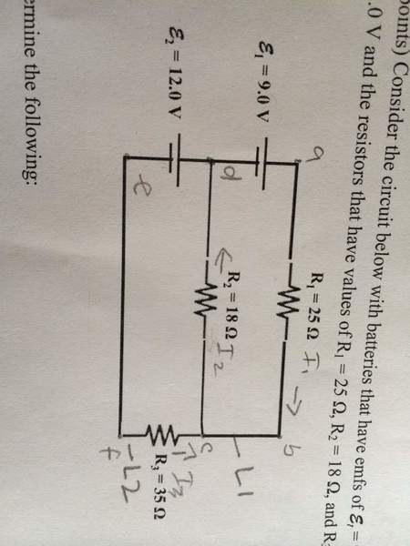

emuhlay08
this is a rough diagram of the picture, please note the direction of the current. that is what is throwing me off right now. The answer I get for I3 is 8.2 ohms and that seems a bit unrealistic to me.
the question is
a) what is the magnitude of the current in each resistor
b) what are the directions of the current in each resistor
thanks in advance!

Well, apart from the picture being impossible to interpret, the answer simply cannot be 8.2 ohm as currents are measured in ampere.
Otherwise it should be a simple matter of applying Kirchoff's laws. Assume a current for each resistor and see where it takes you. If you write down how you arrive at your result, it will be easier to see if and where you go wrong.
I meant Amps, sorry. Even though, it seems like a very large number. Also, I uploaded a picture of the circuit so it can be interpreted.
So, what relations have you obtained from Kirchoff's laws?
