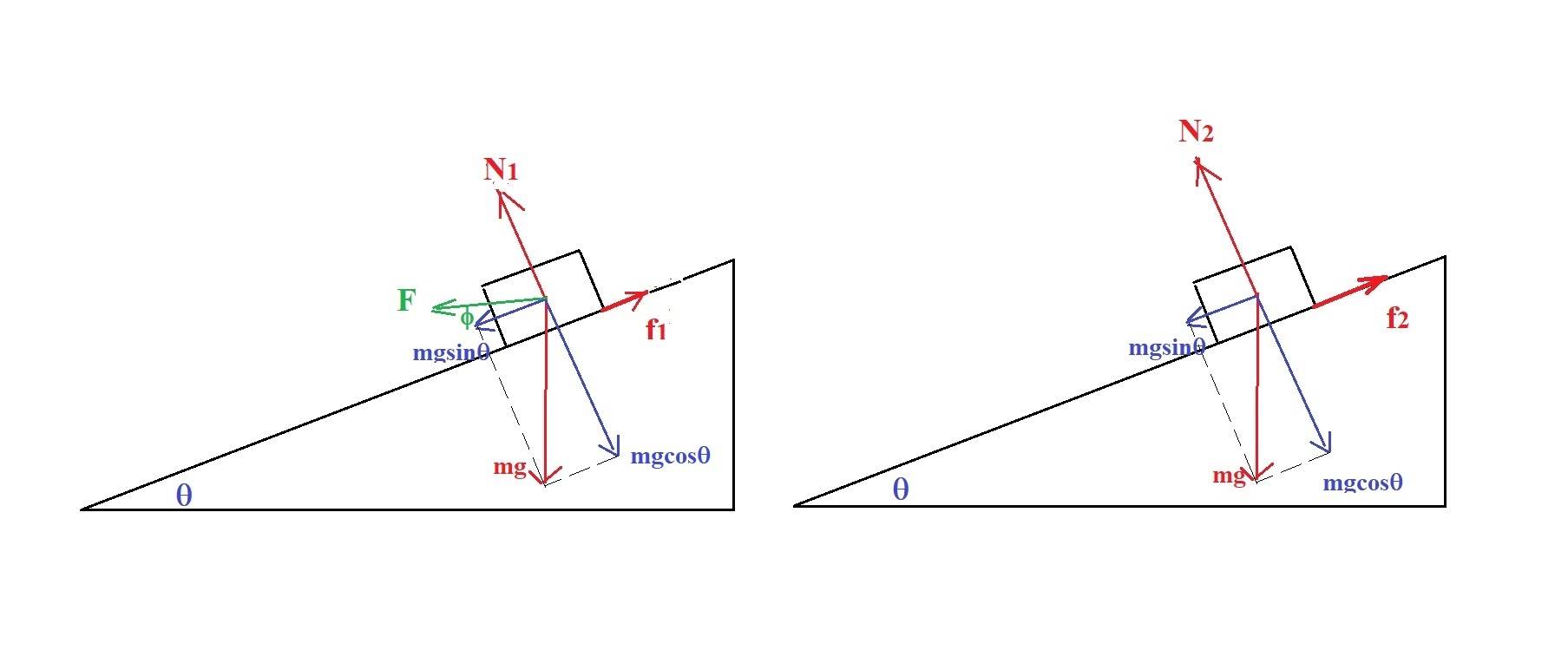

A boy drags a sledge of mass 4kg from rest down a rough slope at an angle of 18 degree to the horizontal. He pulls it with a force of 8N for 3s by a rope that is angled at 10 degree above the parallel down the slope. After 3s the rope becomes detached from the sledge. The coefficient of friction between the slope and the sledge is 0.4. Find the total distance the sledge has moved down the slope from when the boy started dragging it until it comes to rest.
For the first part before the rope is detached
I calculated
R=40cos 18+8sin 10
Coefficient of friction =0.514
F=m×a
So I got a = 0.003m/s^2.
I then calculated s= ut +1/2 at^2 and got s1 =0.0135m.
I calculated v=0.009m/s
Part 2 when the rope is detached
R=40cos 18
By using F=m×a
I got a=0.714m/s^2.
Iam not getting the right ans for the total distance.
The ans in the textbook is 18.5m.
Pls help

$ma = mg\sin(18) + 8\cos(10) - \mu[mg\cos(18) - 8\sin(10)]$
try again
I did your way and got a= 0.35m/s^2, v=1.05m/s and s=1.575m
Now the second part when the rope is detached
R=40cos18, F=40sin18 -0.4×40cos18, F=2.84N, using F=m×a, I get a=0.71m/s^2, and s2=0.776m. I still don't get the ans 18.5m
recheck your acceleration calculation during the drag …
https://www.physicsforums.com/attachments/11134
I did not understand in the second part when the rope is detached, how is it 10 sin 18 + 2 cos 10. Shouldn't it be R = 40 cos 18 and F= 40sin 18- 0.4(40cos 18)
during the drag …
$a_1 = 10\sin(18) + 2\cos(10) - 0.4[10\cos(18) - 2\sin(10)] = 1.39 \, m/s^2$
$\Delta x_1 = \dfrac{1}{2}a_1 \cdot 3^2 = 6.28 \, m$
$v_1 = 0 + a_1 \cdot 3 = 4.18 \, m/s$after the rope is detached …
$a_2 = 10\sin(18) - 4\cos(18) = -0.714 \, m/s^2$
$\Delta x_2 = \dfrac{0^2- v_1^2}{2a_2} = 12.25 \, m$
total displacement = 6.28 + 12.25 = 18.5 m

Can you also pls explain why I don't need to take the normal contact force and the force between the slope and the sledge?
The Normal Reaction force, $N$, is perpendicular to the incline. Reference the two FBD's attached ...
during the drag by the 8N applied force,
$N_1 = mg\cos{\theta} - F\sin{\phi} \implies f_1 = \mu(mg\cos{\theta} - F\sin{\phi})$
after the dragging force is gone,
$N_2 = mg\cos{\theta} \implies f_2 = \mu mg\cos{\theta}$

I understood. Thank you so so so much!
I understood this. I was doing the silly mistake of finding a new coefficient of friction. Thank you so so much for explaining!
