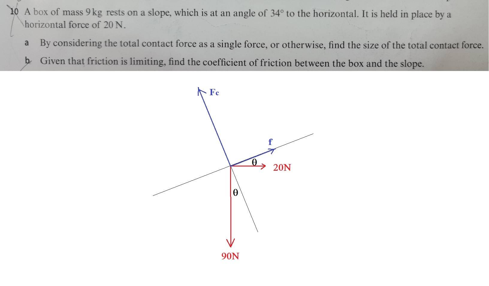

It's the 10th question. Iam getting the ans for R=90cos34= 74.6 and F=-30.3N, so I get total contact force by using the formula c= sqroot(f^2+R^2)= 80.52N
The ans in the textbook is 92.2N. Iam not getting the right ans for coefficient of friction also which is 0.393

I get $\mu = 0.393$ ...

I've provided the correct FBD ... this one is on you.
Hint: the system is in static equilibrium in both the parallel & perpendicular directions respective to the incline.

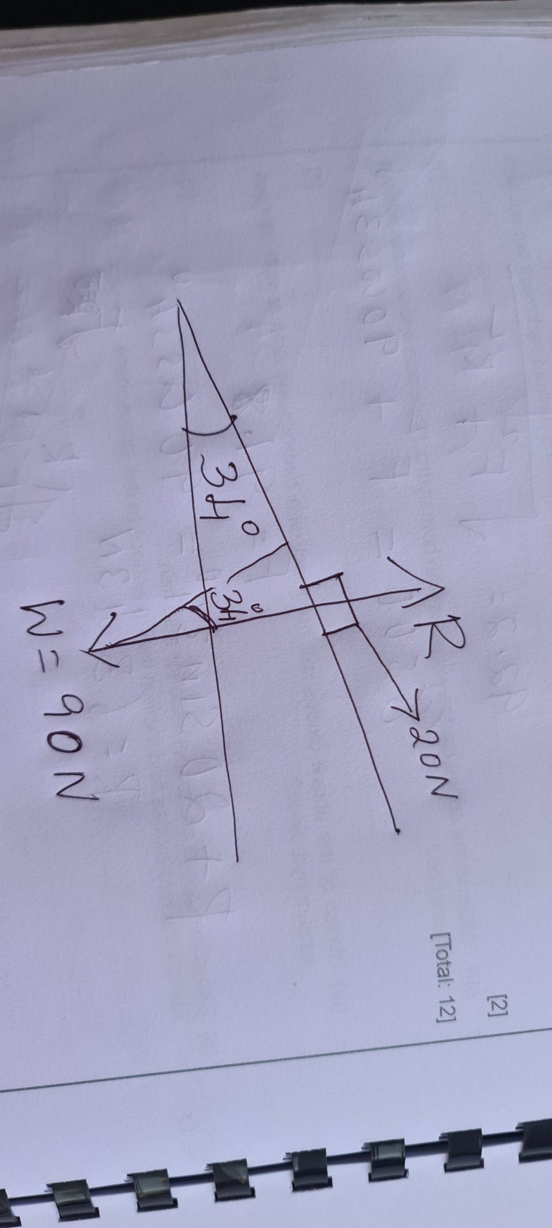

R=90cos34
F=90sin34-20
Mu=0.406
I don't get the right ans
R is incorrect … what about the component of the 20N applied force perpendicular to the incline?
F net is incorrect … the component of the 20N applied force parallel to the incline is not 20.

R+20sin34= 90cos34
Is this the way to do?

The problem statement says the 20N force is horizontal … that would be w/respect to the Earth’s surface, not the surface of the incline.
The reaction force in your diagram is also incorrect.
Your FBD looks nothing like the one I posted.
If you still can’t get the correct value for $\mu$, I recommend you seek assistance from your instructor.
I’m done.
Ok no problem. I will try to work it out. Thank you!

I got the ans. So F= 33.7N and R=85.8N
I got the ans 0.393.
