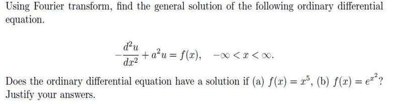

absolute76
i have found the general solution which is,
u(x)= (C1 + C2x)e^ax + (1/2a)[tex]\int f(x-y) e^\left|y\right| dy<br /> <br /> is this correct??<br /> now, i just want your help to guide me for justifying f(x)=x^5...<br /> <br /> is that wrong if i solve the integration and just substitute the integral which is the range( infinity to negative infinity)??<br /> <br /> thank you...[/tex]

[tex] That doesn't look correct. Could you show the work that led you to this result? Also, since there is no one agreed-upon definition of the Fourier transform, tell us what formalism you are using.<br /> <br /> I know just enough about Fourier transforms to be dangerous. I've asked other homework helpers who are better versed than am I in Fourier transforms to jump in and help. Until then, show some work and try to think about the second part of the question.<br /> <br /> A hint for that: Are those functions square integrable?[/tex]
I Fourier transform both sides and I get this:
u~(k) = 1/(k^2 + a^2) . f~(k)
From table,
1/(k^2 + a^2) = √(∏/2) (e^-a|x|/a)----> denotes this as g~(k)
u~(k) = g~(k)*f~(k) ----> applied convolution
After convolution, I get 1/2a ∫f(x-y) e^-a|y| dy ; range -∞<y<∞
Is it correct up until here??

You've correctly found the particular solution, [itex]u_p(x)=\frac{1}{2a}\int_{-\infty}^{\infty}f(x-y)e^{-a|y|}dy[/itex], (assuming [itex]a>0[/itex]) via Fourier Transform methods. But [itex](c_1+c_2x)e^{ax}[/itex] does not satisfy the homogeneous equation [itex]-\frac{d^2 u}{dx^2}+a^2u=0[/itex], and so it is not the correct homogeneous solution.

-d^2 u/dx^2 + a^u = 0
2nd order homogeneous eq.
-λ^2(e^ λx)+a^2e ^λx = 0
- λ^2+a^2=0
a^2= λ^2
a= λ ------- y=(c1+c2x)e^ax
is this wrong??
[tex]a^2=\lambda^2\implies a=\pm\lambda[/tex]
You have two distinct roots, not one double root.

oh issit that way?? i thought
a=(λ^2)^1/2
and will give us a=λ because we cancel the 2x(1/2)??
No, [itex](-\lambda)^2=\lambda^2[/itex]. You can't only take the positive root, and then claim that it is a repeated root. It's the exact same concept as solving the equation [itex]x^2=c[/itex]; both [itex]x=\sqrt{c}[/itex] and [itex]x=-\sqrt{c}[/itex] are solutions.

anyway I am aware that for the second part f(x)=x^5,
1/2a ∫(x-y)^5 e^-a|y| dy -∞<y<∞
right??
I am aware that i have to use convergence test..isn't it the same?
i have to integrate it and substitue the range?
please correct me if I am wrong,

If u don’t mind, can I ask one more question..
2 d²u/dx² - x du/dx + u =0
For this question, I already Fourier transform both sides which give me,
u~(k)[-2k² - xik + 1]=0… but it is impossible if just u~(k)=0
do you have any idea of solving it?

[tex]F\left[x\frac{du}{dx}\right]\neq ikx\tilde{u}(k)[/tex]
There is a rule that tells you how to take the FT of the product of [itex]x^n[/itex] with any function...use that rule.

u~[-2k² + 1] = i/2∏ [d/dk u~(k)]
I transfer, xu’ to the right side
It this correct??
doesnt [d/dk u~(k)] =iku~(k)
is the same?
You're missing a factor of [itex]k[/itex] and you don't need the [itex]1/2\pi[/itex]:
[tex]F\left[x\frac{du}{dx}\right]=i\frac{d}{dk}\left(F\left[\frac{du}{dx}\right]\right)=i\frac{d}{dk}\left[(ik)\tilde{u}(k)\right]=-k\frac{d\tilde{u}}{dk}[/tex]

Actually, I made an error in my previous post:
[tex]i\frac{d}{dk}\left[(ik)\tilde{u}(k)\right]\neq-k\frac{d\tilde{u}}{dk}[/itex]<br /> <br /> You will need to use the product rule to carry out the derivative.[/tex]

[tex] <br /> [tex] i\frac{d}{dk}\left[(ik)\tilde{u}(k)\right][/tex]<br /> <br /> owk i think i got it, is it correct...i(iu~(k)-k²u~(k))<br /> <br /> that will give me -u~(k)+ik²u~(k)---->u~(k)[-1+ik²]??<br /> <br /> owk how do i separate u~(k) so that it don't cancel each other(left and right side)??[/tex]

[tex]i\frac{d}{dk}\left[(ik)\tilde{u}\right]=-\frac{d}{dk}\left[k\tilde{u}\right]=-\left(\tilde{u}\frac{dk}{dk}+k\frac{d\tilde{u}}{dk}\right)=-\tilde{u}-k\frac{d\tilde{u}}{dk}[/tex]
This is a basic application of the product rule.

Ok my mistake again,
so now the equation will be u~(k)[-2k²+2]=-k du~/dk
so u~(k)= [-k/(-2k²+2) du~/dk
Is it correct if i diffrentiate towards k on the right side?

That's correct. So now you have a 1st order ODE to solve instead of the 2nd order one you started with. This one is separable:
[tex]\frac{d\tilde{u}}{\tilde{u}}=2\frac{k^2-1}{k}dk[/tex]

Owk now is this correct?
u~(k)=e^[(k²)-(2 ln k)]
...u~(k)=e^(k²)/e^(2 ln k)
then i transform it using the table?? right?

Right. Although, I doubt your table will give you the inverse FT of this function, so you will probably want to use the convolution theorem with [itex]\tilde{g}(k)=\frac{1}{k^2}[/itex]
ok, so if i want to find the general solution,
should i just let it be in terms of convolution plus the homogenous equation right?
that should be my final general solution.
Right, although in this case, I think your second solution comes from solving [itex]u''(x)=0[/itex] and [itex]xu'-u=0[/tex]. which isn't really "the homogeneous equation".[/itex]
