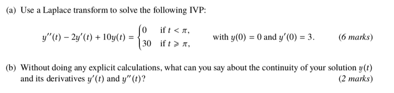

Exam question with part (a): solve the IVP y'' - 2y' + 10y = piecewise forcing, 0 for t < pi and 30 for t >= pi, with y(0) = 0 and y'(0) = 3, using Laplace transform (6 marks); part (b): without explicit calculation, state continuity of y(t) and its derivatives y'(t) and y''(t) (2 marks).

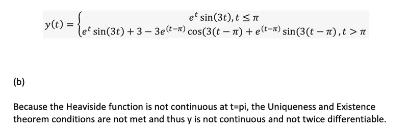

Piecewise solution y(t) equals e^t sin(3t) for t less than or equal to pi, and e^t sin(3t) + 3 - 3e^(t-pi) cos(3(t-pi)) + e^(t-pi) sin(3(t-pi)) for t greater than pi, with the label (b) and a typed explanation below.
This is my answer to the ODE (I think it's correct) via Laplace transform, but I'm more concerned about whether or not my explanation for part b is correct or not?
Any help would be greatly appreciated!!

I observe your solution (a) is continuous at t=π.
Oh yeah you're right, what might be a good explanation for (b) then?
I would expect [itex]y[/itex] and [itex]y'[/itex] to be continuous, and [itex]y''[/itex] to have a jump discontinuity.

OK. First could you calculate second derivative of your solution and show it to us?
Yeah sure I could do that but the question says without doing any explicit calculations?
Okay, the for $$t<=pi$$,
the first derivative is $$e^{t}sin(3t)+3e^{t}cos(3t)$$ and the second derivative is $$-8e^{t}sin(3t)+6e^{t}cos(3t)$$
and for $t>pi$,
the first derivative is $$e^{t}sin(3t)+3e^{t}cos(3t)+10e^{t-\pi}sin(3(t-\pi))$$ and the second derivative is $$-8e^{t}sin(3t)+6e^{t}cos(3t)+10e^{t-\pi}sin(3(t-\pi))+30e^{t-\pi}cos(3(t-\pi))$$
Thanks for your effort. Say your sokution is y
[tex]y^"=-8e^{t}sin(3t)+6e^{t}cos(3t)=8e^\pi[/tex] at t=##\pi-0##
[tex]y^"=-8e^{t}sin(3t)+6e^{t}cos(3t)+10e^{t-\pi}sin(3(t-\pi))+30e^{t-\pi}cos(3(t-\pi))=8e^\pi+30[/tex] at t=##\pi+0##. We see discotinuity of gap 30 at at t=##\pi## in y".
You have already found that y is continuas at t=##\pi##. You can easily check that y' is continuous too there.

Because the highest derivative is the most badly behaved. This accords with our physical intuition, and guarantees that the lower order derivatives will actually exist.
The way of solving this equation without transforms is as a particular integral (which is zero for [itex]t \leq \pi[/itex]) plus a linear combination of complementary functions. The coefficients of the complementary functions in [itex][0,\pi][/itex] are fixed by the conditions at zero; the cofficients in [itex](\pi,\infty)[/itex] are fixed by requiring [itex]y[/itex] and [itex]y'[/itex] to be continuous at [itex]\pi[/itex].
This is also the solution obtained by the Laplace transform method, if you use the result [tex] \mathcal{L}(y') = p\mathcal{L}(y) - y(0).[/tex] If [itex]y[/itex] were discontinuous at [itex]\pi[/itex], you would instead have [tex] \mathcal{L}(y') = p\mathcal{L}(y) + (y(\pi^{-}) - y(\pi^{+}))e^{-p\pi} - y(0)[/tex] with a similar result for [itex]\mathcal{L}(y'')[/itex].
