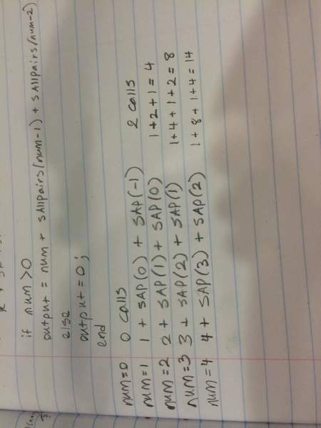

Suppose you are given the recursion function sAllPairs, given as
Code:
function output = sAllPairs(num)
if num > 0
    output = num + sAllPairs(num-1) + sAllPairs(num-2);
else
    output = 0;
end
a) what is the output of the command sAllPairs(4)?
b) How many recursive calls are made when issuing the command sAllPairs(4)?

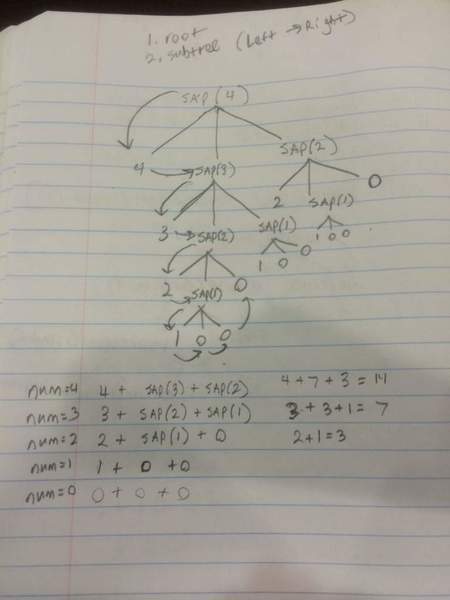

I was able to calculate on paper and confirm that the answer is 14 for part (a), but I am confused once again about how to traverse the tree. I know for pre-order traversal you process the root, then the subtree from left to right. However, after I process the root, I get to the left subtree, and it's sibling is a root to another subtree. So when that happens, I am uncertain how to traverse through this thing.
I would start from num=0:
How many function calls does sAllPairs(0) produce?
Based on that result, how many function calls does sAllPairs(1) produce?
Based on that result, how many function calls does sAllPairs(4) produce?
Is my tree correct? I have doubts that the root would be sAllPairs(0)
##\bullet## So for num = 0, 0 + sAllPairs(-1) + sAllPairs(-2) = 0, it would make 0 recursive calls.
##\bullet## num = 1, you get 1 + sAllpairs(0) + sAllPairs(-1). Thus, 1+0+0. Does that mean it took no recursive calls, since it already knows that the last two are equal to zero due to the else condition?
##\bullet## Then for num = 2, 2 + sAllPairs(1) + sAllPairs(0), so 2+1+0. So it makes 1 recursive call
##\bullet## num = 3, 3 + sAllPairs(2) + sAllPairs(1), so 3+3+1 = 7. It makes 2 recursive calls
##\bullet## Finally, num = 4, 4+ sAllPairs(3) + sAllPairs(2), 4+7+3 = 14. It makes 2 recursive calls
for a total of 2+2+1 = 5 calls. I don''t know if this is the proper way to count calls though. If I am supposed to count any time I see sAllPairs for a num, then it would be 2 + 2 + 2 + 2 + 2 = 10, I just don't understand how one should count.

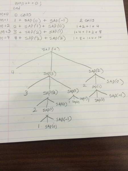

I calculate 14 calls for num=4, and 8 calls for num=3
I wrote up the tree and if you count all the children for a given SAP(num), I found 8 and 14 for SAP(3) and SAP(4), respectively. Now, my question is, how is it traversing this tree?
The rule for pre-order traversal is process root, then subtree from left to right. So I start at SAP(4), then go to 4. Where I'm stuck is understanding whether it will go to 3, or will it go to SAP(3).
I am checking how the code works and I see it goes to 3, but I am confused as to why. If the rule is process root, then process subtree left to right, well isn't SAP a root, hence should come before 3 which is a child of SAP(3)??
I agree.
You get the same number just by counting all function nodes in your tree apart from the top one.

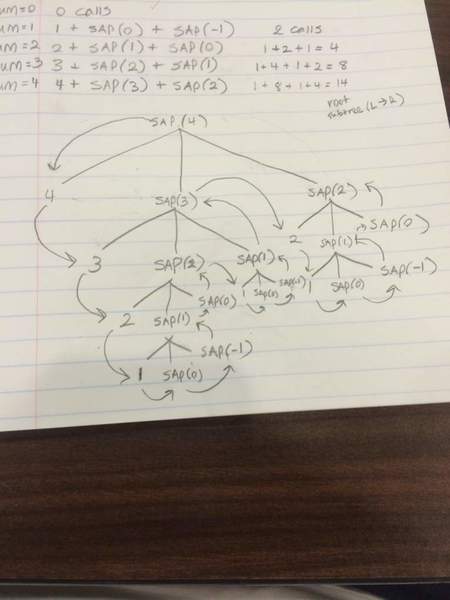

I ran the function and got this as the traversal. I think where I am tripping up is some confusion over where it will go. So it will go from the root and get all the left subtrees that it can, which goes all the way down to 1, then it will go to SAP(0), SAP(-1), then finally connect with another root at SAP(1). But then after SAP(1), it goes up to SAP(2), instead of 1. I could see that if it didn't process that root it wouldn't ever have an opportunity to come back to it, but I guess it seems inconsistent that it would process that rooti nstead of the left subtree.
It's a bit confusing that you include the integers, they are not function calls.
Instead of 4->3->2->..., it should start with SAP(4)->SAP(3)->SAP(2)->... which is always the call at the left side of the addition process.
So in a tree, only function calls should be present??
So can the tree traverse the same node twice? I am looking at the bottom left of the tree, specifically at the bottom SAP(0). It can either go back up to SAP(2), then over to SAP(1), or SAP(0) -> SAP(1) which I wrote, or SAP(0) to SAP(0). Which way would it go?
