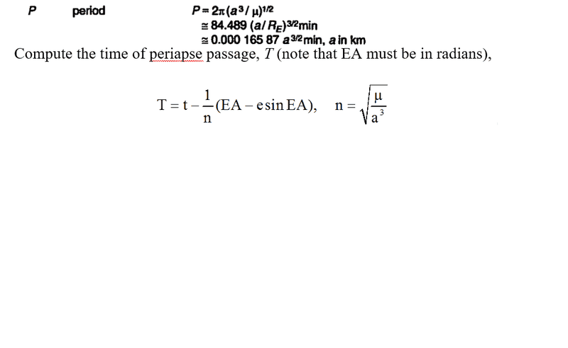

I'm trying to find the period of a satellite orbiting the Earth by the next formulas
with: miu= 398600.5;
a=36770.48 km;
I. 2*pi*(a^3/miu)^1/2
II. 84.489*(a/Re)^(3/2)min
III. 0.00016587*a^(3/2)min
And I got aprox. 19 hours from both formulas (I. and III.) which is correct.
Can anyone please explain to me how do you get from the first formula to the second and third,what transformations should I make and also who is Re?

That is a weird and inconsistent way to handle units.
Re should be the radius of Earth.
You can just plug in numbers, then the formulas can be converted into each other. (I) is the one closest to the derivation via the forces on a satellite.
As an easier example: You can rewrite "10*x" as "5*b*x" if you define b=2. If you have Re=6370, you can get it into formulas in the same way. Sometimes that makes the formula handier.For the second problem I think something is missing. Time relative to what? Where do the orbital parameters come from?

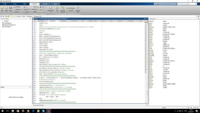

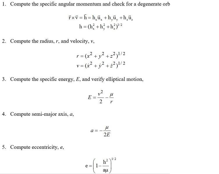

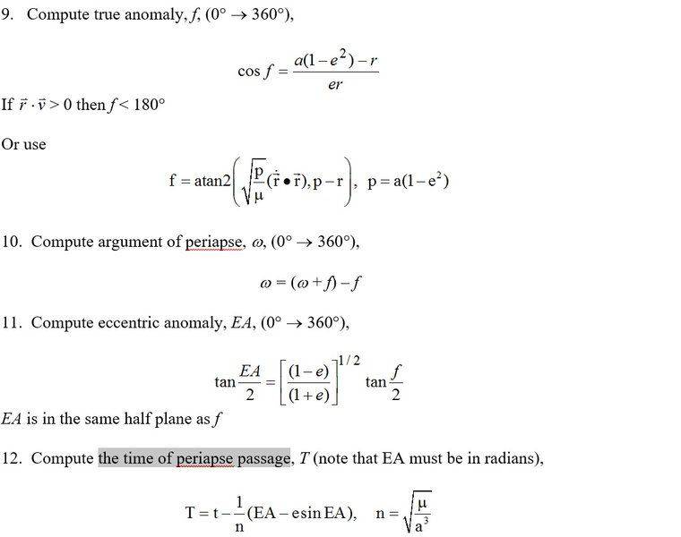

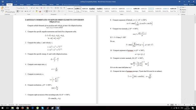

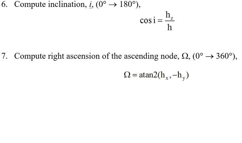

First of all, thank you for your response, it has been very helpful.As for the second problem I've written the above MATLAB code. It uses the values of position vector and velocity vector to determine the orbital elements.As you can see the values for a and e and other elements are correct so I believe that t is the moment in time at which those values for the vectors.For my code I've use the above steps.

t=270;
miu= 398600.5;
Position values
Rx=1.120260101155629e+03;
Ry=-5.997082966407411e+03;
Rz=-3.919879916453886e+03;
Rxyz=[Rx Ry Rz];
Velocity values
Vx=5.0702;
Vy=4.9659;
Vz=-6.9805;
Vxyz=[Vx Vy Vz];
Angular momentum
hez = cross(Rxyz,Vxyz);
N = cross([0,0,1],hez);
hx=hez(1,1);
hy=hez(1,2);
hz=hez(1,3);
he=((hx^2)+(hy^2)+(hz^2))^(1/2)
R=((Rx^2)+(Ry^2)+(Rz^2))^(1/2); radius
Vel=((Vx^2)+(Vy^2)+(Vz^2))^(1/2);speed
E=((Vel^2)/2)-(miu/R);%Energy
ac= -(miu/(2*E)); semi-major axis
Excentricity e
e_vec = ((norm(Vxyz)^2 - miu/norm(Rxyz))*Rxyz - dot(Rxyz,Vxyz)*Vxyz)/miu;
ecc = norm(e_vec);
Inclination
inc=acos(hz/he);
ig=radtodeg(inc); in degree
Omega
OM=atan2(hx , -hy);
if N(2) < 0 quadrant check;
OM = 2*pi - OM;
end
OMg=radtodeg(OM)%OMEGA in degree;
True anomaly
tra=acos((ac*(1-ecc^2)-R)/(ecc*R));
if dot(Rxyz,Vxyz) < 0 quadrant check;
tra = 2*pi - tra;
end
trag=radtodeg(tra) ; in degree
Argument of periapse w
om= acos(dot(N,e_vec)/(norm(N)*ecc));
if e_vec(3) < 0 quadrant check;
om = 2*pi - om;
end
omg=radtodeg(om); in degree
Eccentric anomaly
EA=acos((ecc+cos(tra))/(1+ecc*cos(tra)));
The time of periapse passage
n=sqrt(miu/ac^3);
T0=t-(1/n)*(EA-ecc*sin(EA))
The values for the vector are from T=70172.6768628;%Period
and t=270; Those values I've use when I've done the conversion from orbital to cartesian and the output was the values of the 2 vectors.
Based on the following images. Sorry for the poor quality of the above images!
