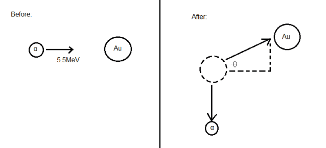

An alpha particle traveling with a kinetic energy of 5.5 MeV and a rest-mass of 3727.8 MeV/c^2 strikes a gold atom with a rest-mass of 183,476 MeV/c^2.
-The gold atom is initially at rest
-The alpha particle deflects perpendicular to the horizontal in the after state

AFTER STATE:
Conservation of momentum:
in x: P(Au)cosθ=202.6MeV/c (1)
in y: P(Au)sinθ-P(α)=0 (2)

However, when I plug these numbers back into equation (3) the solution doesn't come out right. I have been looking over this for hours and can't figure out where my error might be.
Thanks!
Possibly algebra problems?
Go through each step carefully - without going too deep, the following stood out:
E(Au)=√(P(Au)^2+183476^2)
E(α)=√(P(α)^2+3727.8^2)
Are you missing a c^2 in there? Typo?

I looked back over each step carefully. I must have made my mistake when solving for Pα in Equation 3. I ended up writing a script on MATLAB that solved for the three unknowns and got the answers that way. Thanks for the tips!
That's where I think it first went pear shaped too ... the c^2 thing you can get away with by adopting units so that c=1. Many people do that implicitly.
A good discipline is to do all the algebra in the symbols, leaving the numbers to last.
Worst case is, you'll have a clear path to backtrack and troubleshoot - in this case, a lot was hidden when you combined numbers so I couldn't tell what you'd done.
