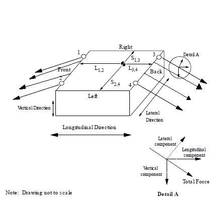

The system I am looking at is something like the one below, with 4 straps of each side. Their locations relative to the center of gravity along the lateral direction is not symmetric but back to front they are symmetric. Each strap has a lateral, longitudinal and vertical component. I need to determine the tension in each of the straps when resisting an acceleration of 3g in the longitudinal direction.
The problem I am have is I only have 2 equations,
A force balance, i.e. T1 + T2 + T3 + T4 = mass*3*g
And a moment blance, i.e. T1*y1+T2*y2 = T3*y3 + T4*y4
Where T1 … T4 are the tensions in the longitudinal direction, and y1 .. y4 are the distances from the CG along the lateral axis.
Am I missing something?

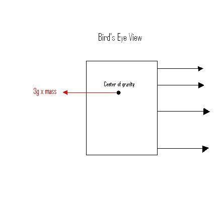

Edit: To clarify I drew a bird's eye view of the problem. The black arrows represent tie down lines, the red arrow represent a force acting through the center of mass due to an acceleration of 3g's

I think your system is not statically determinate so you will not have enough equations.
However you haven't yet exhausted the possibilities since you haven't taken connection reactions into account.
It is not clear whether there are four straps passing over the box and forces are transferred by friction or whether there are eight straps anchored along the top edges of the box. Either way there are plenty of connection reactions to add to your list.
It is also not clear why ( and how ) you are claiming forces at right angles to the straps, which you are modelling as strings that cannot support such forces.
Sorry the bird's eye view is a bit misleading, the straps are at an angle to the vertical, longitudinal and lateral axes, but in the bird's eye view I just showed the longitudinal component for simplicity. The straps are anchored on the edges.

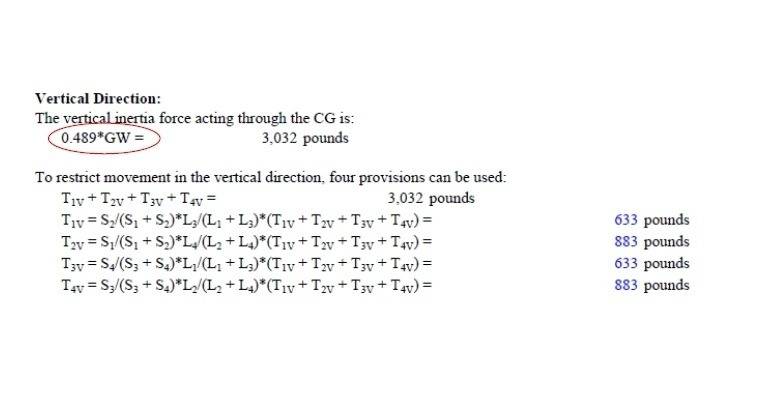

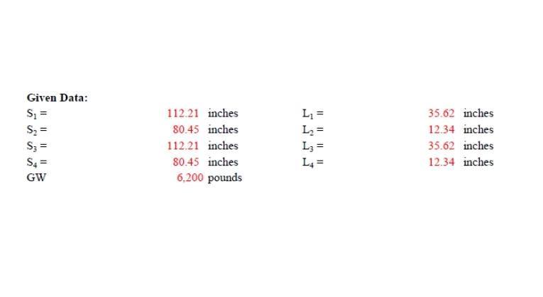

I have a slightly different question but it is along the same lines. Assuming you have only 4 tie downs such as shown below, how do they come up with the solution below? I have tried playing around with it but I have only 3 equations and 4 unknows, the equations are
[tex]\Sigma[/tex]Fz: T1v + T2v + T3v + T4v = Mass * G
[tex]\Sigma[/tex]Mx: T1vS1 + T3vS3 = T2vS2 + T4vS4
[tex]\Sigma[/tex]My: T1vL1 + T2vL2 = T3vL3 + T4vL4
I assume it has to due with some symmetry condition i.e. that S1 = S3, S2 = S4, L1 = L3 and L2 = L4 , but I can't seem to get the algebra right, any tips?
