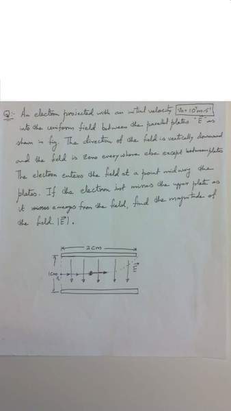

ok i have a problem to work on in my new course, and i was wondering what i need to do to tackle it. the question is as follows:
An electron is projected with an initial velocity Vo=10^7m/s into the uniform field between the parallel plates "E". the direction of the field is vertically downward and the field is zero everywhere else except between plates. the electron enters the field at a point midway the plates. if the electron just misses the upper plate as it uses energy from the field, find the magnitude of the field "E"
are these the formulas needed
F = ma = qE
s = ut + 0.5 at^2
v = u + at
v^2 = u^2 + 2as
and what does ( a, u, and s) stand for?

ok i believe gravity is in play here, attached is diagram i scanned

Due to the statement of your problem, unless you had omitted something, this is going to get slightly messy :):
So, firstly, there's no change in the absolute value of the velocity, since the electric field acts perpendicular to the initial velocity.
this means that at any moment in time [itex]|\vec{v}| = v_0[/itex]
v_y which had no initial velocity in it, we'll define as:
[itex]v_y = at -> a = a_e-g[/itex] a_e is the acceleration due to the electric field.
Integrating, that gives us: [itex]Y = {at^2}/2[/itex]
We need to find time t' when, the particle has finished traveling 1 cm, which I'll call h.
that gives us [itex]t' = \sqrt{\frac{2h}{a}}[/itex]
That's not true. There will be no change in the horizontal component of the velocity, but the vertical component will change, thus the speed will change. This is just like a projectile under the influence of a constant gravitational field, only in this case it's an electric field providing the force (and hence acceleration).

hey danielakkerma after staring at the free body diagram for a while i finally came to the conclusion that gneill is absolutely right! and that this is very much like a projectile with an initial velocity which is influenced by an acceleration mimicking that of gravity. also since the angle at which it is projected is zero, it actually makes things easier! i basically set up these following equations [itex]\Delta[/itex]X=V0t and
[itex]\Delta[/itex]Y=(1/2)at2. we solve for t in the deltaX equation substitute it for t in the deltaY equation. solve for acceleration. then we have F=ma. we use mass*acceleration to find the force. then we fave F=-eE. after some algebraic manipulation we come to find that E=(ma/-e)! man it feels so good to get it right! thanks for all your help you guys.
