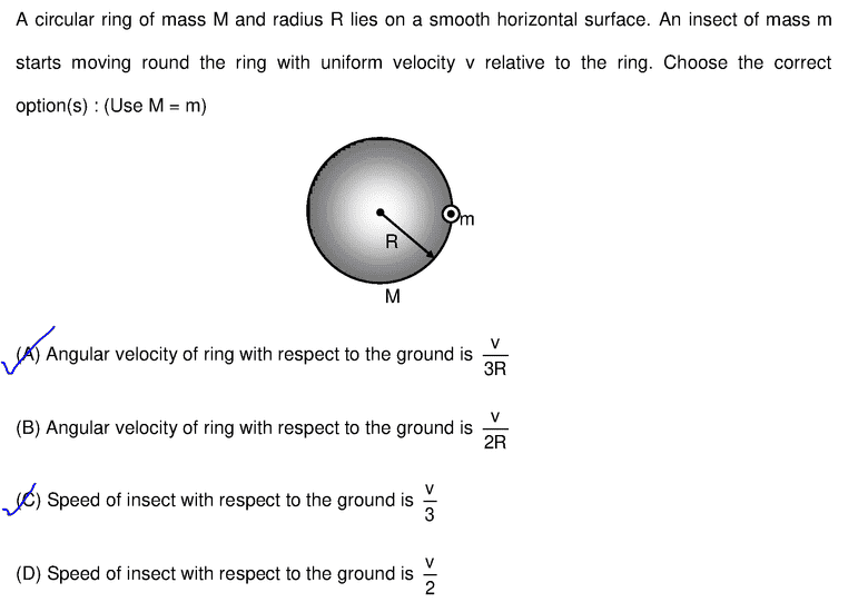

I have posted the question below. My question is how to form the equations to solve the question below.

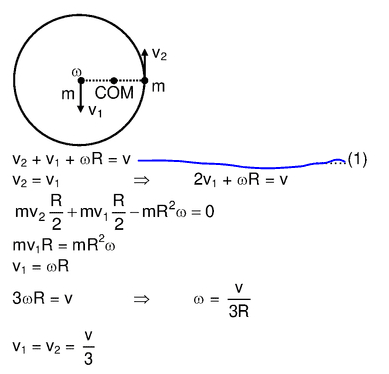

I've marked correct answers above. Have a look at the solutions:
How is the first equation justified? Shouldn't v2 and ωR be of opposite signs? What is v1? And how is it equal to v2? My biggest problem is the source of v1 since the ring is not having vertical displacement, then what is v1?
Don't confuse the rotation of the line joining the mass centres, which will be anticlockwise, with the rotation of the ring about its own centre, which will therefore be clockwise so that total angular momentum remains zero.
ω is the rate of the latter.
v1 is the velocity of the ring's mass centre in the ground frame. v2 is the velocity of the bug in the ground frame. These must be equal and opposite so that total linear momentum remains zero.
So, the first equation is for the rotation for line joining the center of masses. Okay. But, if the bug moves upwards (let's say) then the ring will rotate clockwise and so the direction of v1 and ωR would be same, right? Wouldn't they be of opposite signs? You did say the rotation will be anti-clockwise, am I mistaking somewhere or did you consider the bug to move down?
So the ring does have some motion along the vertical plane right? It's kinda hard to visualize though. Can I conclude that the ring will keep bouncing all the time?
No, I wrote "the latter", i.e. the rotation of the ring about its own centre.
Yes, it is hard to visualise. Part of the difficulty is that we are only concerned with the instantaneous velocities at the starting position. It will soon look rather different. To minimise this problem, take the part of the circle where the bug is to be a straight line.
Try drawing a diagram showing:
  • The initial positions of mass centre, ring centre and bug
  • Positions of ring centre, bug, and the point X on the ring where the bug started, after a short time t.
The mass centre does not move.
The ring centre will have moved down v1t, X will have moved further down, and the bug will have moved up v2t.
Likes Gourab_chill and etotheipi
It's a fiddly little thing. You need to be careful to think about in which frames of reference angular momentum and/or linear momentum are conserved. They're both conserved in the lab frame, and also in the CM frame of the whole system.
Once you've got that, it's more a matter of just being careful with the algebra in finding the correct relative velocities.
Likes Lnewqban
