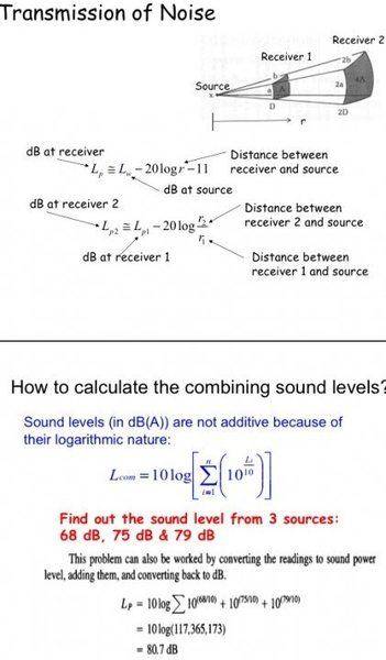

A sound level reading of 132 dB was taken near a construction site where some
chippers were being used. When only one chipper was working, the sound level
reading was 122 dB. Assume that all the chippers are located at the same point.
Estimate the number of chippers in operation when the reading of 132 dB was
obtained.
(The attached photo)
I have no idea how to do it...
Can anyone help me?
Thanks
Your attachment spells out how to sum sound sources given their dB levels. Just imagine that instead of having different L1, L2, L3, etc., you have n copies of one sound level L1. You'll need to exercise a bit of your algebra of logarithms and exponents knowledge.

Sound levels (in dB) don't sum algebraically because they are based on logarithms. When you sum logs you are effectively multiplying the underlying quantities, not adding them. When you take the difference between logs you are effectively dividing one by the other.
Sound intensity is a linear quantity (Watts per square meter) that can be summed algebraically. That is, if there are sound sources with Intensities ##I_1, I_2, ...,I_n## then the intensities sum: ##I_{sum} = I_1 + I_2 +,...,+ I_n##.
So when you want to sum up the contributions of independent sound sources which are specified in terms of dB, you need to sum their intensities, not their levels, then convert the resulting intensity sum back to the level in dB.
Now you should know that sound level L in dB is defined in terms of a reference power level ##I_o = 10^{-12}W/m^2##, so that by definition ##L = 10 log(\frac{I}{I_o})## . Thus:
##\frac{L}{10} = log(\frac{I}{I_o})##
##10^{\frac{L}{10}} = \frac{I}{I_o}##
So you can sum the quantities ##10^{\frac{L_i}{10}}## to obtain the net ##\frac{I}{I_o}##. That is what the formula in your attachment is showing:
$$L_{com} = 10 log \left[ \sum_{i = 1}^n \left(10^{\frac{L_i}{10}} \right) \right]$$
The summation sign is summing the individual ##\frac{I_i}{I_o}## quantities and the result is converted to the net sound level in dB by taking the log and multiplying by 10.
