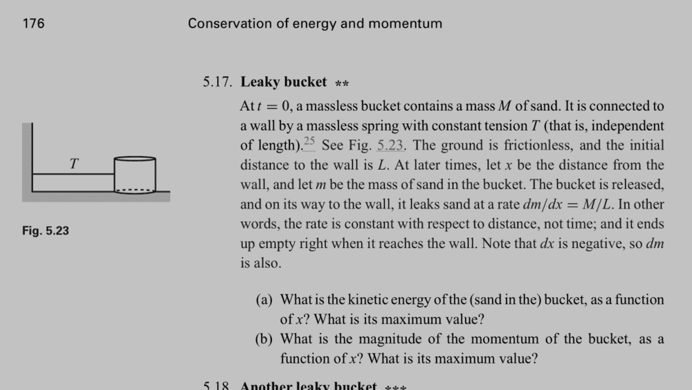

This is the exercise from Morin's book on classical mechanics. The problem is as follows:
Consider a leaky bucket pulled by a string towards wall(see screenshot). The bucket leaks all the way which is constant (i.e ##dm/dx = \lambda## where m is the instantaneous mass of bucket. He asks to calculate kinetic energy as the function of distance
##dE/dx= F##

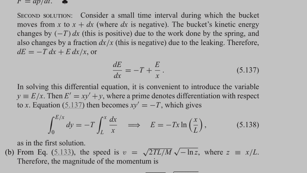

I attempted the solution using force method. I got correct. However, I was stuck at the alternative way to solve problem using energy method. As shown in screenshot 2, he tells that the energy of system changes due to 2 ways:
- The tension T
- Leaking of mass
As shown in screenshot 2 ,the leaking of mass contributes dx/x. My question is how this expression comes up? Please detailed justification and Thanks in advance

As the mass moves an incremental distance x, it loses a fraction of its mass. If it is at distance 10 and moves incrementally by dx, it will lose dx/10 of its mass. If it is at distance x, it will lose a fraction, dx/x, of its mass.
If it loses dx/x of its mass, it loses dx/x of its energy.
Just as Morin says, the contribution to dE from this is E dx/x.

Try obtaining the equation for m as a function of x. The leak contributes ##\frac 12 v^2dm## to dE. Substitute for ##v^2## using E.

How can it lose dx/x fraction? The rate of leaking is constant. So ##dE= 1/2 dm v^2 = 1/2 \lambda dx v^2 = E dx/L## since ##\lambda= M/L##. I want justification for dx/x.

The rate of leaking is constant. So ##dE= 1/2 dm v^2 = 1/2 \lambda dx v^2 = E dx/L##.
The last equality is not correct. It looks like you assumed that ##E = \frac{1}{2}Mv^2##. But the mass of sand in the bucket is not ##M## (except at the initial point of release).

Ok. So, I tried doing the dE. However,to get correct answer I have to assume dm/dx= M/x. Otherwise I get L everytime. Can you elaborate your answer please?
As @TSny writes, you substituted E/M for ½v2, but E depends on the current mass, m, not the initial mass, M
