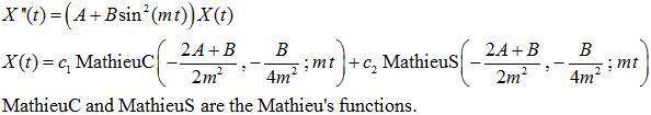

You can't on the way you are thinking of.
The solutions cannot be expressed as a combination of a finite number of usual functions. In similar cases, some special functions were defined in order to represent the solutions on a closed form (see the example below, in case of a simpler equation). As far as I know, it was not done in the case of your equation. So, do not expect to find an exact analytical equation X=f(t).
Of course, this ODE can be solved and the result can be plot, thanks to numerical computation methods.
Another way for Physicians is to replace the equation by another simpler one which can be analyticaly solved, if the physical phenomena can be modeled with some approximations on some limited ranges of the parameters.
  • Equations: X''(t) = (A + B sin^2(mt)) X(t), with solution X(t) = c1 MathieuC(-(2A+B)/(2m^2), -B/(4m^2); mt) + c2 MathieuS(-(2A+B)/(2m^2), -B/(4m^2); mt), followed by the note MathieuC and MathieuS are the Mathieu's functions.
