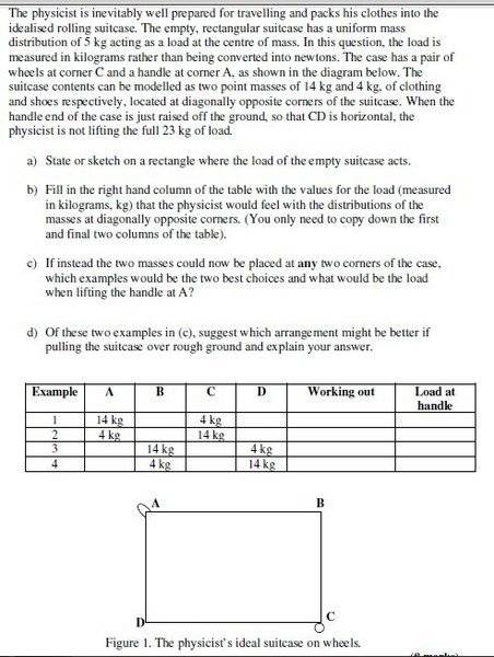

Regarding part (c) (i), as we know that we can consider any of the convenient point as our pivot. If I consider the point where the 5kg mass (center of mass of the bag) acts, the asnwer turns out to be wrong. The correct answer has 4kg mass as pivot
14(0.5x)=m(0.5x)+4(0.5x)
m=mass to be found
x=distance from the 5kg mass I have considered as pivot
According to the equation above, x cancels out and we should get m=10kg, but the answer is 4+5(1/2)=16.5kg. Kindly explain why my approach is wrong and why can't we take the center of mass of the bag as our pivot?[/B]
You can take the center as your axis, but you must include the torque due to all forces. There's an upward normal force acting at point C. (That's one reason to take point C as the pivot.)

Asad Raza said:
Therefore, kindly spare some of your precious time in answering what force it is?
I'm not sure I understand your question. You do realize that the ground is supporting the suitcase with an upward force at C, right? To figure out what that force is, you'll need a second equation.

Asad Raza said:
You got my question right, but the reaction force will only exist if there's a contact with the ground. Here, the bag is being lifted up the ground and there's no apparent contact
The bag is still in contact with the ground at point C. (It's just being barely lifted so that end of the bag at point D just leaves the ground.)
If the bag was not supported by the ground, there would be no equilibrium.

Asad Raza said:
I am still not clear that how does the normal reaction causes a moment about the axis.
The normal force is like any other force acting on the bag.
Draw the free body diagram. It would show the normal force acting at point C. That creates a torque about any point except point C.

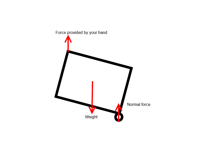

I probably shouldn't draw it for you but here is a partial FBD anyway. I have left off the magnitude of the forces and assumed the case is empty. Got to leave you some work to do :-)
Note that the weight acts at the centre of mass (not at the wheel if that's what you were thinking). The Normal force acts at the wheel and there is another force on the handle. I have assumed the force at the handle acts vertically but it need not.
Just to clarify this.
Technically the weight of the case is distributed over the case. However that would be difficult (but not impossible to model). The simplest way to model it is to show the weight acting at the centre of mass which is roughly in the middle of the case if the mass is evenly distributed.
