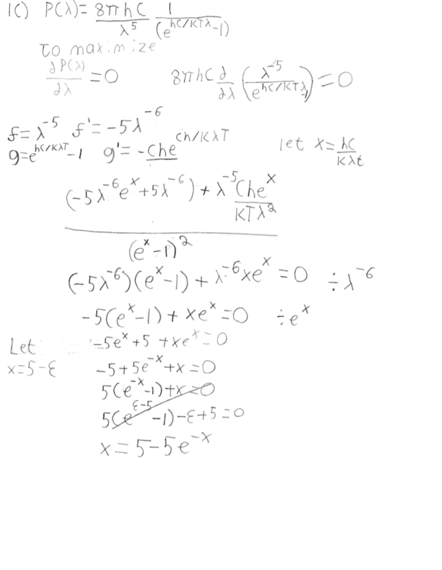

Hello, I have attached my attempt at a solution. All is okay until i reach x=5-5e^-x. My assignment suggests that i solve it by substituting x=5-ε into the equation where ε is assumed to be small. Solve for ε and then solved for x (Approximate).
Thank you for your help

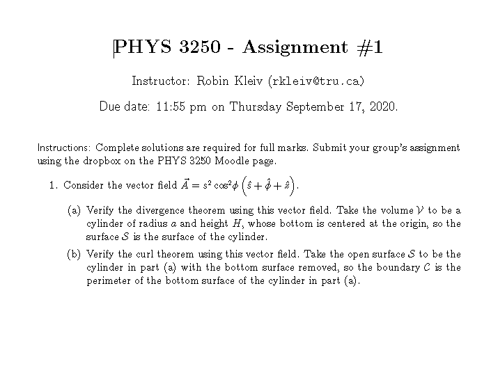

The attachment appears only to be the problem statement. Did you mean to also attach your work?
Also, your thread title implies that you got a transcendental equation as part of your work. Is that what you mean?

Sorry about that wrong file , I will correct that.
Here the file i intended on uploading, ignore the first file as it is irrelevant to the question.
Substitute in for ##x## to get an expression involving ##\varepsilon##. Then expand ##e^\varepsilon## as a series to first order. See where that gets you.
Thank you for your help i have figured it out.
