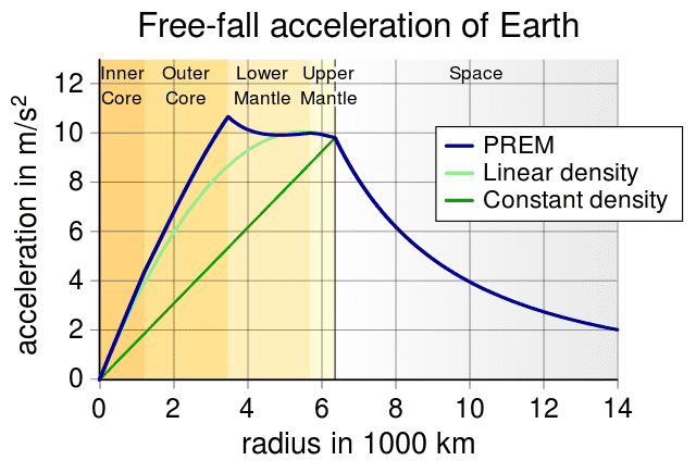

Im looking for some easy equotation which would help me to make graph of time dilation depending on gravity expressed not in relation to Schwarzschild radius but simply and directly to gravitational acceleration. I would like to get some easy graph similar to this:
http://frigg.physastro.mnsu.edu/~eskridge/astr101/timedilat.gif
But instead of time dilation / speed there would be time dilation / gravitational accelaration in m/s2.
Is something like this possible or I can't get rid of this radius in the equotation?

The coordinate acceleration of a free faller in a hovering frame, is related to the radial derivative of gravitational time dilation. But note that you cannot have gravitational time dilation as an unambiguous function of that acceleration, because there are radii with the same acceleration but different gravitational time dilation (inside and outside of the mass).

You can approximate proper time, in the case of weak (constant) gravitational fields and slow velocities by using the gravitational potential [itex]\Phi[/itex] and the velocity [itex]v[/itex]:
[itex]\delta \tau \approx \delta t (1 + \frac{\Phi}{c^2} - \frac{v^2}{2 c^2})[/itex]
So the two kinds of "energy" in Newtonian physics--gravitational potential energy and kinetic energy--work in opposite ways to affect time dilation. Clocks with more kinetic energy (larger [itex]v[/itex]) tend to run slower, while clocks with larger potential energy (larger [itex]\Phi[/itex]) tend to run faster.
Note that what comes into the time dilation formula is gravitational potential, not gravitational acceleration. The two are related by:
[itex]\vec{g} = - \nabla \Phi[/itex]
where [itex]\nabla[/itex] is the gradient operator: [itex]\nabla = \hat{x} \frac{\partial}{\partial x} + \hat{y} \frac{\partial}{\partial y} + \hat{z} \frac{\partial}{\partial z}[/itex]

Or the center of the mass where gravitational acceleration is zero (like far away from the mass), but the gravitational time dilation is maximal (relative to far away from the mass).

My humble opinion is that this is a wrong interpretation of the equotation, because there is difference if you calculate time dilation for example for the center of Sun and time dilation on the surface of the Sun. If you have radius zero, than you have also M zero, because you can't calculate the M of Sun which is above the radius. So in the center of the Sun there is zero time dilation.

You are confusing gravitational force with gravitational potential. You are right that the force is zero at radius zero, but the potential is not (this is standard classical mechanics, no relativity needed) and it's the potential that goes into the time dilation equation that stevendaryl posted.

You would have to dig really deep, to reach a region where the gravitation acceleration decreases, to confirm that gravitation time dilation still increases (if that's what you want to confirm)
But quantitative experiments already confirm that gravitation time dilation is a function of graviational potential, not of graviational acceleration.

Pretty much all of them. It's easy to see the difference because the acceleration goes as ##1/r^2## while the potential goes as ##1/r## outside the surface of the gravitating body. GPS wouldn't work if we had gotten this wrong.
