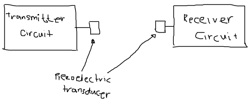

Hello! I have a system depicted below. I need to know what is the working equation that governs the transmit and receive power of the transmitter and receiver in the diagram. The transmitted signal is a sound wave and not an RF signal, the transmission is underwater. I would like to know what is the governing equation that models the transmit and receive power that also related to the distance between the tx and rx. Thank You!
Hand-drawn block diagram: a box labeled Transmitter Circuit connects to a small square piezoelectric transducer, and a box labeled Receiver Circuit connects to a second small square transducer, with arrows pointing from the label Piezoelectric transducer to each transducer.
  • Hand-drawn block diagram: a box labeled Transmitter Circuit connects to a small square piezoelectric transducer, and a box labeled Receiver Circuit connects to a second small square transducer, with arrows pointing from the label Piezoelectric transducer to each transducer.
so you will have a known TX power. What things do you think will affect the amount of power detected by the receiver ?

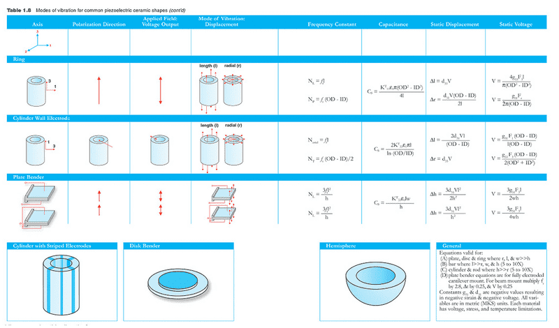

here's the link for the piezoceramic ring i will be using https://www.steminc.com/pzt/en/piezo-ceramic-cylinder-26x22x13mm-43-khz.
The datasheet says that cylinder is meant to be used in Hoop Mode vibration. Is that what you are wanting to use? That would not seem to be an efficient way to couple ultrasonic energy to water, unless I'm missing something. Also notice how it says that the input impedance is around 10 Ohms at resonance (in air). What do you think the input impedance is in water? Do you think it will couple well to water? I'm guessing you should find a plate US coupler that is impedance matched to the water, if you want to have an efficient system...

https://www.americanpiezo.com/images/figures/table1-82.png
Table 1.8 of piezoelectric vibration modes for ceramic shapes, listing ring, cylinder wall electrode and plate bender with their displacement, frequency, capacitance and voltage formulas.
  • Table 1.8 of piezoelectric vibration modes for ceramic shapes, listing ring, cylinder wall electrode and plate bender with their displacement, frequency, capacitance and voltage formulas.
Hello! I will use potting compound to encapsulate the transducer to prevent contact to any conductive fluid. The potting compound is Urethane which has a density identical to to that of water, providing for mechanical to acoustical energy coupling.

Embedded in the datasheet for the cylinder is a link to the UCSD Modem which uses that cylinder. It is informative. It includes a reference to the "passive sonar equation" (for a receiver with no directivity)
That is part of what confuses me about the OP and his first post. He seems to clearly show a directed channel Tx --> Rx, and then he suggests he's using a Hoop Mode omnidirectional piezo transducer.
I'm not sure what you find so strange about it. He seems to be proposing to use an underwater transmitter-receiver pair. Especially if the transmitter and receiver are not held in some fixed geometry, one of the easiest things to do would be dangle both in the water at some reasonable (perhaps even the same) depths and transmit/receive omnidirectionally. A hoop-pattern transmitter is pretty standard for this.
Yes, you may be right. For some reason I remembered horn antennas shown on the diagram in his OP. I see now that they are just squares, maybe implying omni transducers.
