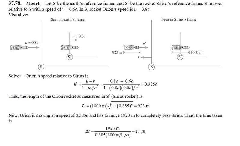

i did the question exactly like how they did it. expect i did not add the length contraction of 923m to 1000m, then find time.. what i did was find the speed with respect to me which was 0.385c
so d=vt t =d/v= 8.8*10-6 s
can some one tell me where i went wrong.pls.
thanks in advance
You used the wrong distance. You found the time for the nose of Orion to go from the tail to the nose of Sirius, but that's not the same as for Orion to completely pass. Draw a diagram for yourself (or just study the one given).
