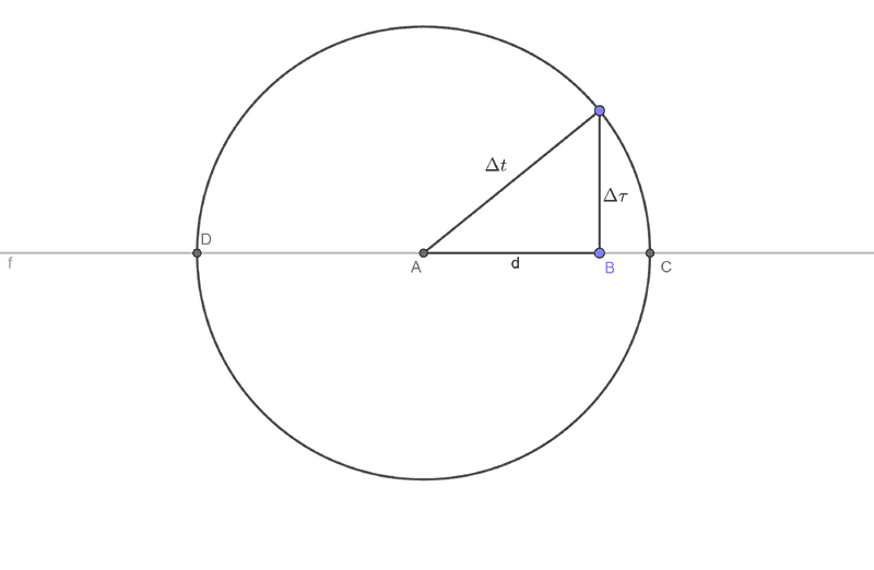

I’m always surprised at the time difference, (and I know this isn’t exactly the same scenario that OP described), but if the spaceship is providing just 1g of acceleration in the direction of travel for the first half of the journey and in the opposite direction for the second half (starting and ending at rest wrt Earth), then the passengers on board will age less than 14 years for a 1000 LY trip. In this scenario, the passengers have to spend 3.8-ish more years aboard the ship than they would in the OP’s scenario, but they’ll be able to board and de-board the spaceship without dying (necessarily).
In the scenario of inertial motion, there’s a straightforward formula for the required speed ##\beta##:
$$\beta=\frac{d}{\sqrt{\Delta \tau^2+d^2}}$$
This follows directly from the invariant interval. The proper time ##\Delta \tau## is related to the coordinate time and spatial distance by:
$$\Delta \tau=\sqrt{\Delta t^2-d^2}
\Rightarrow
\Delta t=\sqrt{\Delta \tau^2+d^2}$$
Substituting into ##\beta=\frac{d}{\Delta t}## gives the result.
The nice thing about this approach is that it allows for a geometric interpretation/solution. The speed is the ratio between ##AB## and ##AC##. This diagram also nicely shows the relation between ##d##, ##t## and ##\tau##.
