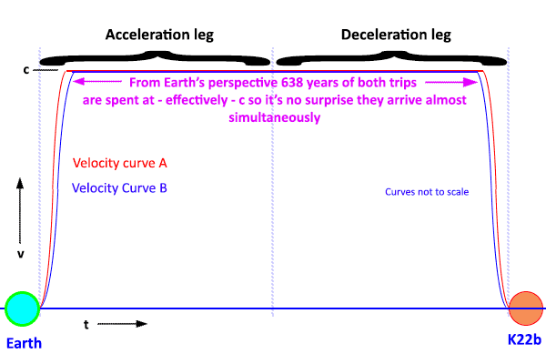

bbbl67 said:
No, acceleration is the entire first half of the trip, while deceleration is the entire second half.
Of course, I was not suggesting otherwise. But it's not the point. It's not about the acceleration/deceleration (which, yes, each last half the trip), its about absolute velocity with respect to Earth.
At 1g or at 3g, they both reach ~c within leSs than a year. And then their velocities stay there for ~639 years before dropping back to zero.
So, for 99.8% of the entire journey, they are both moving wrt Earth at, effectively, c. There is no time dilation to factor-in when viewing the scenario from Earth's perspective. It would take sone pretty fancy telescope-foo to observe the difference in velocity between .9999994919c and .9999954455c.
It should be no surprise that they arrive almost simultaneously from Earth's perspective.

DaveC426913 said:
You miss the point.
The velocity curve rises to ~c within about year and stays there for ~639 years and then drops back to zero in about a year.
So, for 99.8% of the entire journey, they are both moving wrt Earth at effectively, c.
The problem is that even though the graph looks pretty flat and the maximum speed looks pretty close, in the middle part of the graph from our very scaled out perspective; if you zoom in to specific parts of the middle of the journey, they are not actually very close. Ship A gets to a maximum of 0.9999994919c, while ship B gets to a maximum of 0.9999954455c, therefore there is a 0.0000040464c differential between their velocities relative to c. That produces a huge time dilation differential at those speeds. They are still accelerating and decelerating at 3g vs. 1g, respectively, even at those speeds.
Time dilation is irrelevant to Earth's perspective regarding arrival time. That's the specific scenario we are discussing in this sidebar (if you go back and check post 8).
Earth sees two ships - both reach c (to within many decimals) within a year, and then spend 639 years there. Their velocities - and therefore total trip duration - from Earth do not inolve time dilation at all.
So, the 0.9999994919/0.9999954455 difference results in a mere 1.3 years delay, as seen from Earth.
Why is that a problem?
@Dale: bbbl67 and I are sort of talking past each other, I think. And it's my fault.
All this arose because in my first post - post 2 - I said "One thing seems odd off the top of my head: Ship B is restricted to only 1g for the entire trip, yet manages to arrive a mere 1.3 years later than ship A?"
In post 8, I realized why:
DaveC426913 said:
Of course! :slaps forehead: view from Earth does not include any time dilation. Both journeys are effectively at c...
So I see why the two trips arrives almost simultaneously.
But - I phrased it poorly:
DaveC426913 said:
... minus accel and decel legs, which are very brief, relatively.
bbbl67 picked up on my misspeak. And now that I read it a third time, I see what he means:
bbbl67 said:
No, acceleration is the entire first half of the trip, while deceleration is the entire second half. The very brief amount of time spent is the point at which they are switching from acceleration to deceleration.
He is correct. My comment was poorly-phrased and seems to suggest the accel/decel legs of the trip only lasted a short time.
What I should have said is that the effective velocity from Earth's perspective is ~c for 99.6% of the journey - and that virtually all the velocity incease/decrease happens in the first and last year only (as per my diagram).
So, in answering my own question: You'd have tough time measuring the difference between the two ships, one going at 0.9999994919c and the other going at 0.9999954455c. Which is why they arrive almost simultaneously from Earth's perspective.
From Earth's persective and measurements, acceleration (i.e. delta v over delta t) is, in fact, observed to drop off dramatically very rapidly in the trip, as it approaches c (even though the engines are still firing the whole time) and likewise, decel only really starts slowing from c in the last year.
Thanks to @bbbl67 for calling out that poor choice of words. It was unintentionally misleading.
We now return you to your regularly scheduled programming.

Perhaps an appropriate time to post this:

"...will the androids see the humans arriving on Kepler 22b: 7.7 years later, or 1.3 years later?"
The answer is 7.7 years later.
(It is Earth that sees them arrive 1.3 years apart.)
This is wrong. On Kepler they also see the humans arriving 1.3 years later. It is the proper time of the journey itself that is 7.7 years longer for the humans. Since the androids also spend 1.3 years on Kepler before the humans arrive, they will be 6.4 years younger.
