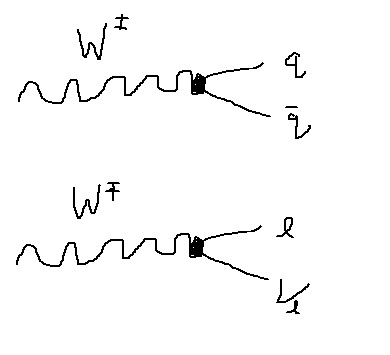

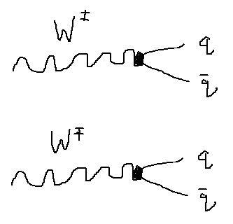

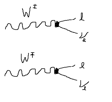

(a) Explain the results.
(b) Why is the cross section much higher? Suggest the dominant decay product pair.[/B]
[/B]
Part(a)
For a centre of mass energy of ##170GeV##, you produce pairs of oppositely charged ##W^{\pm},W^{\mp}## bosons. It is kinematically forbidden to produce ##Z,Z## pair and forbidden by charge to produce ##Z,W^{\pm}## pairs.
First group of 4 hadronic jets can be explained by production of 2 pairs of quark/anti-quark stream. Number of combinations = 3x4 = 12 because of 3 colours possible. ~45%
Second group can be explained by a quark/anti-quark stream and a lepton/neutrino stream. Number of possibilities = 3x2 + 2x3 = 12. (3 types of leptons, 2 charge types) ~45%
Third group can be explained by 2 pairs of lepton/neutrino stream. Number of possibilities = 3 (leptons must be oppositely charged) ~10%
Part (b)
This question stumbled me. Is there something special happening at 125 GeV? I suppose the heaviest quark-anti-quark pair it can decay to is the bottom/anti-bottom quark? Why is the cross section so much higher? Why is it that in part (a) only {u,d,c,s} quarks/anti-quarks are produced and not bottom (b) quarks??

Why 4? And what about the other W?
Ok, now thinking about it - each W boson can produce 5 possible types of quarks (u,d,s,c,b) so possibilities are 5x5 = 25? But 3 types of colour so 25x3 = 75.
mfb said:
I don't understand what you are adding here.
For the second picture, 5 quark possibilities, 3 types of colour, 3 types of leptons, 2 charges of leptons so 5x3x3x2 = 90? Doesn't match the first one.
mfb said:
What about the other W?
For the third picture, 3 types of leptons but the W bosons must be oppositely charged, so 3 types for the other W boson. So 3x3 = 9
The numbers are all wrong...
mfb said:
The LHC found a particle at this energy.
Right.
What does the Higgs couple to?
That is a mistake you have to fix in (a).
Right, should have noticed they were talking about the Higgs! The Higgs boson couples to mass, so it naturally has an extremely large cross section with the heaviest possible quark, bottom quark. Why is it 40,000 times as large though?
Sorry, I was thinking of Z decays with my comment about five quarks. No b in W decays as the top is too heavy.
You don't have so many options for the W. Let's consider the W+ boson: it either decays to up+antidown or charm+antistrange. Just two options, multiplied by three for colors => 6.
The W- has 6 options as well.

Why can't the W+ boson decay to charm/antidown? It is calibbo suppressed by ##sin 13^o ## but it is possible? Also why can't W+ boson decay to ##u\bar u, d\bar d, c\bar c## pairs?
First picture
6 options for each W.
Total = 6x6=36 options
Second picture:
Quark producing W can either be W+ or w- = 2x6 = 12 options
For the lepton decay, 3 options.
Total = 12x3=36 options
Third Picture
3 options for each.
Total = 3x3 = 9 options
It can, but the probability is small. Small enough to neglect it.
Quark + antiquark of the same type would violate charge conservation.
The new numbers look right.
